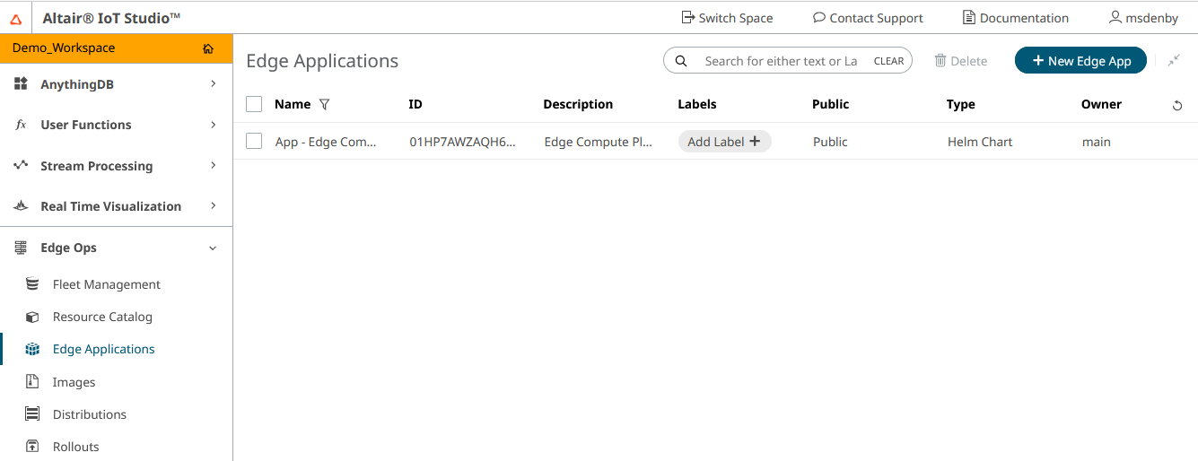

  2. Go to Edge Ops > Edge Applications.
    You will see the app just installed, as in the following image:
