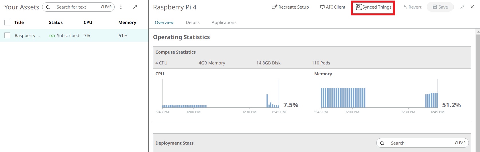

    3. Choose your Raspberry Pi 4 device from the Fleet Management section and add the new Edge Application from the Applications tab.

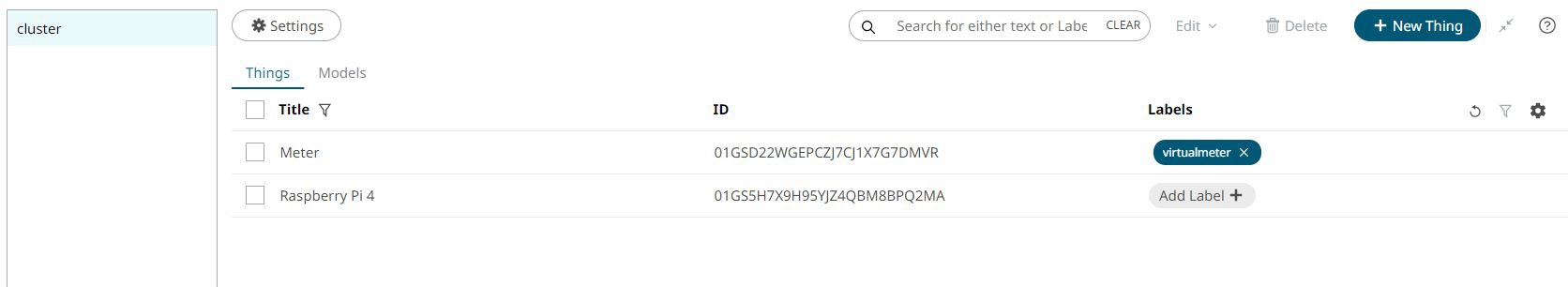

    1. Add a Label to this Thing.

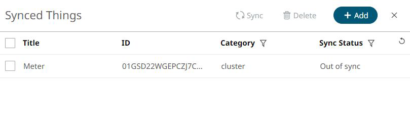

    2. Navigate to the Fleet Management section, choose your Raspberry Pi 4 Thing and click Synced Things.

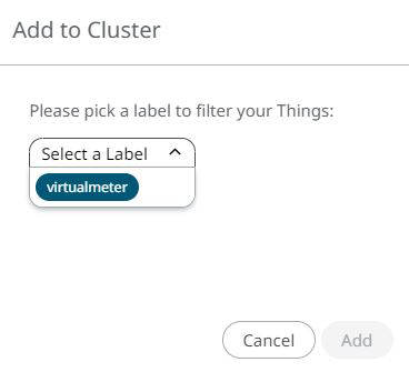

    3. Click Add and choose the label you have just created and assigned to the Thing.
      When completed, a pop up message is displayed and the synchronized Things are shown in the list.
