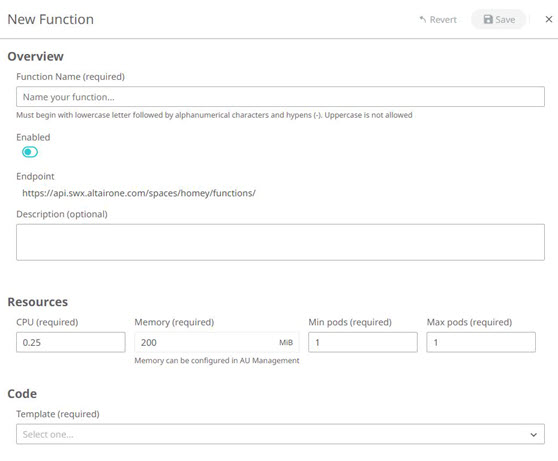

Create a Function
  1. Under User Functions, click Functions.
  2. Click New Function.
  3. Enter the Function's name and description (optional).
  4. From the Template drop down menu, choose the type of Function you want to code:
    • FMU: Upload an FMU file to run a simulation model
    • Go: Code your serverless Function using Go language
    • Python: Code your serverless Function using Python language
  5. If you choose to run a simulation model by using a FMU, upload the FMU file and click Save. Go to Step 9.
  6. If you choose to code your serverless function (either using Go or Python language), the libraries drop-down displays the available libraries you can use while coding. To use any library, select it from the list provided.
    Note: This action will allow you to add it to your template, but you will still need to add the import line to your code.
    The code appears in the panel.
