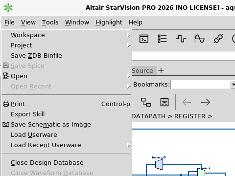

You can access the dialog to open files through the menu:
Or by using the corresponding open icon in the toolbar:
Use this icon
 to show the 'Read Spice' dialog.
or this icon
 to show the 'Open File' dialog.
