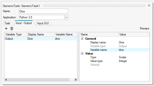

  2. Create an application template.
    1. From the Author ribbon, Create group, select the Application Template tool.
      The ApplicationTemplate dialog opens and a generic task is created in the Block Diagram.
    2. In the ApplicationTemplate dialog, enter Dice for Name.
    3. For Application, select Python.
    4. In the Task tab, select Script.
    5. For Script language, select Python.
    6. For Script name, browse and select the Python script located in the pulse\casino_game\Script folder.
    7. In the Variables tab, click .
    8. Click the newly created study to populate the Preview.
    9. For Display name, enter Dice.
    10. For Variable name, enter dice.
    11. Verify the Type is set to Scalar and Value type is set to Integer.
    12. For Originate from, select Task.
    13. Close the ApplicationTemplate dialog.

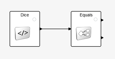

  3. Connect tasks.
    1. Optional: If necessary, adjust the locations of the tasks in the Block Diagram so they can easily be connected.
    2. In the Block Diagram, connect the output port of Dice to the input port of Equals.
      Figure 4.
    3. Right-click the connection and select Edit from the context menu.
      The Link dialog opens.
    4. In the Link dialog, Output column, select Dice (dice) for a (a) input.
      Note: The Value/Expression should be populated with =Dice_1_dice. This means that input a is equal to the output variable dice of instance 1 of the Dice module. One must specify the instance number because multiple modules, in this case Dice, could been present in the process. This is called Local Variable Mapping.
    5. Close the Link dialog.

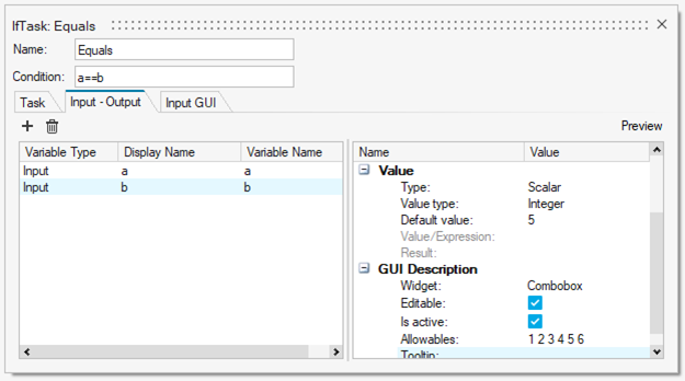

  4. Modify Widget.
    1. In the Block Diagram, right-click the Equals task and select Edit from the context menu.
      The If Task dialog opens.
    2. In the Variables tab of the If Task dialog, select the b variable.
    3. In the GUI Description, select Combobox for Widget.
    4. For Allowables, enter 1 2 3 4 5 6.
      Figure 5.
    5. For variable a, change the Display Name to Dice Number and for variable b, change Display Name to Lucky Number.
