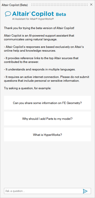

Start Altair Copilot
- In the upper-right corner of the application window, click Altair
                            Copilot (Beta)
, or click . - In the
                            Ask
                            a question field, enter a question and press
                        Enter or click the
                            Send
                        button
 to submit
                            it.Tip:- Altair Copilot keeps track of the current and last question, so when you ask a follow-up question, you can assume it remembers the last question and response. For example, after asking How do I create a lofted surface?, Altair Copilot understands this type of follow-up question: That’s great, but can I retain only intersecting points?

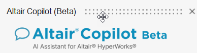

 - To hide the chat interface, click Altair Copilot
                            (Beta)
. Click it again to return to
                        your questions. - Drag or double-click the window header to undock or reposition the window to
                        another location within the application.
