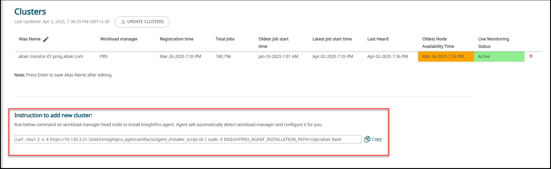

Figure 1. InsightPro - Cluster
Note: By default, there will be no cluster added. Instruction to add a cluster is provided.Administrative privilege is required to add a cluster and to view the instructions for adding a new cluster.
Copy the curl command using
from the
InsightPro portal.
- Login to the workload manager machine as a root or as a user with sudo permission where the InsightPro agent is to be installed.
Enter the curl command that is copied from the InsightPro
portal.
For example:
curl -s -k https://<IP Address>:32443/insightpro_agent/artifacts/\ agent_installer_script.sh | sudo bash
curl --tlsv1.3 -s -k https://172.16.80.62:32443/insightpro_agent/\ artifacts/agent_installer_script.sh |sudo -E \ INSIGHTPRO_AGENT_INSTALLATION_PATH=/opt/altair bash
