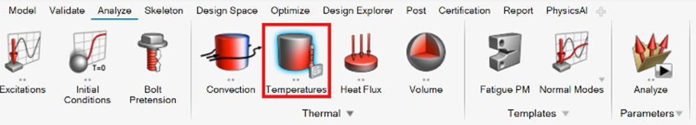

  3. From the Analyze ribbon, Thermal tool group, select Temperatures.

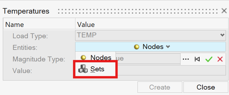

    Figure 10. Add Temperature
  4. For Entities, select Sets from the drop-down menu.
    Figure 11. Select Sets as Entities

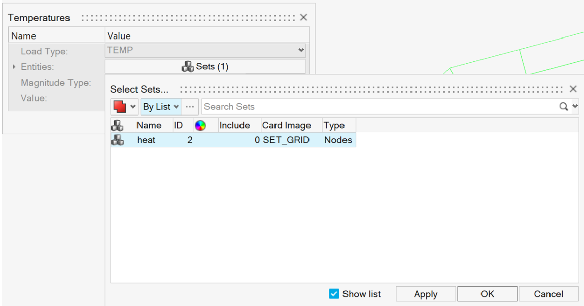

  5. Click Sets > to open Advanced Selection.
    Figure 12. Set Selection for Thermal SPC
  6. Select the predefined entity set heat and click OK.
  7. For Value, enter 0.
  8. Click Create, then Close.
