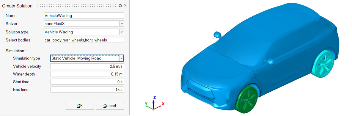

Static Vehicle
The static vehicle approach is simpler and less computationally expensive than the moving vehicle setup and uses a configuration similar to a wind tunnel. The vehicle remains static, but the road and wheels are assigned boundary conditions which mimic the correct vehicle speed. Water approaches the vehicle from an inlet at the front of the channel. The fluid behavior during water entry and exit is not captured.
