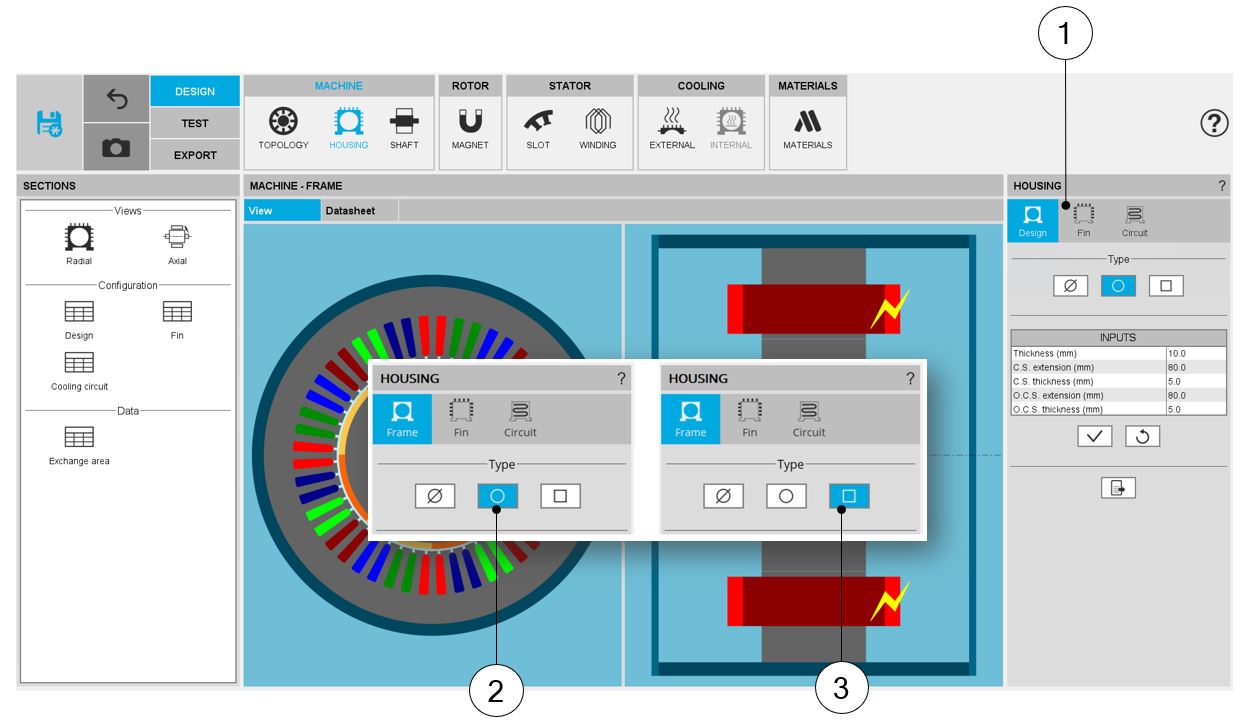

Access to the “Fin” area is unlocked when a frame is defined, whose shape is circular or square.
| How to unlock the “Fin” area ? | |
| 1 | “Fin” area is unlocked (as well as the “Cooling circuit” area). |
| 2 | Selection of a circular shape frame. |
| 3 | Selection of a square shape frame. |

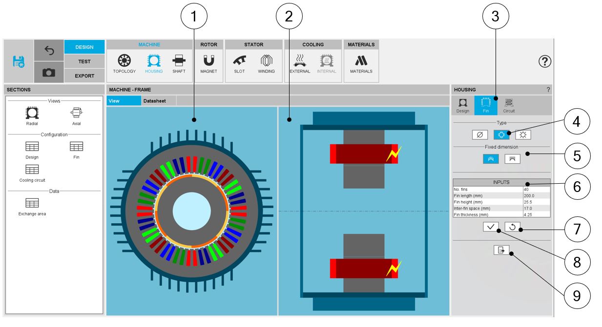

Parallel type fins – Topologies and dimensions
Parallel type fin area
| Parallel type fin design area | |
| 1 | Radial view of the motor, including the housing topology with fin topology and dimensions. |
| 2 | Axial view of the motor, including the housing topology with fin topology and dimensions. |
| 3 | The section fin is selected to define the type and dimensions of the fins. |
| 4 | Selected button to define parallel type fins. |
| 5 | Two ways are possible to define the fin dimensions: "Height" and "Extension" options. See below illustrations. |
| 6 | User input parameters to define the fin dimensions. For more information see below. |
| 7 | Button to restore default input values. |
| 8 | Button to apply inputs. Pressing the enter key twice applies inputs too. |
| 9 | Icon to export frame data into *.txt or *.xls files. |

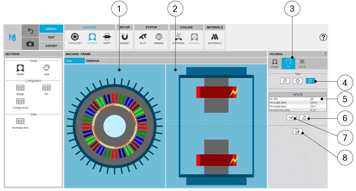

Radial type fins – Topologies and dimensions
Radial type fin area
| Radial type fin design area | |
| 4 | Selected button to define radial type fins. |
| 5 | User input parameters to define the fin characteristics. For more information see below. |
| 6 | Button to restore default input values. |
| 7 | Button to apply inputs. Pressing the enter key twice applies inputs too. |
| 8 | Icon to export frame data into *.txt or *.xls files. |
