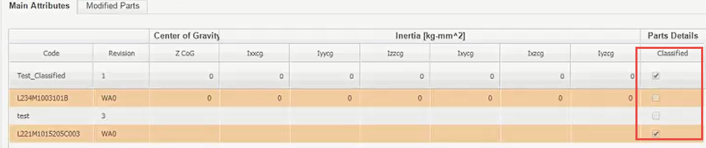

Classified is a new attribute which allows or restricts the visibility of the sensitive parts only to authorised users.

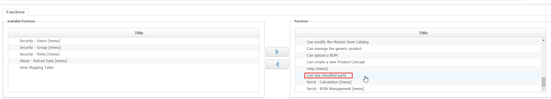

User roles enabled with classified function access can only view the classified parts in the catalogue.
- Parts Catalogue
- BOM Management
- Snapshots
- Risk and Opportunities
- Mission Management
Classified attribute propagates to upper node in Bill of Material, hence when you remove a
classified access from a part, then you are required to remove the access manually from all
the upper nodes.If classified parts are added to an assembly, then the snapshots which contain that
assembly will be restricted to authorised users.When a classified access is removed from a role, then it is also required to remove the
security access from that role.When a user has no classified access and makes a part classified, then that particular part
disappears from the catalogue view.
