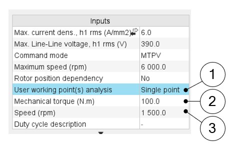

  2. User working point(s) analysis = Single point
    This allows computing the machine performance on a working point which must be specified by the user with the targeted speed and torque. In that case the next two fields must be filled with the targeted speed and mechanical torque.
    Table 1. User working point analysis = Single point
    1 Select the “Single point” option to perform a computation on one working point.
    2-3 Define the targeted working point mechanical torque and speed.

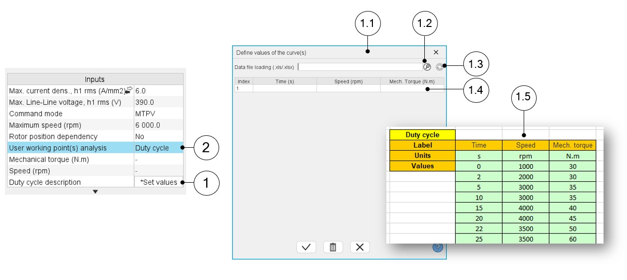

  3. User working point(s) analysis = Duty cycle
    This allows computing the machine performance all over a considered duty cycle.
    This duty cycle must be defined by using the next field: "Duty cycle description" and by clicking on the button "Set values".
    Two ways are possible to fill in the table: either filling in the table line by line or by importing an excel file which all the working points of the duty cycle are defined.
    Note: A working point is defined by a time, a speed, and a mechanical torque.
    Table 2. User working point analysis = Duty cycle
    1 Select the “Duty cycle” option.
    2 Click in the button “Set values” of the field “Duty cycle” to open a dialog box to define the duty cycle.
    Refer to the next illustration which shows how to fill the Duty cycle table.
    1.1 Dialog box opened after having clicked on the button “Set values” in the field “Cycle description”
    1.2 Browse the folder to select an Excel file which describes the duty cycle.
    1.3 Button to refresh the table data when the considered Excel file has been modified.
    1.4 Fields to be filled with data to describe the duty cycle to be considered.
    1.5 Excel file template to define the duty cycle
Note: Once the test results have been computed, new user working point and duty cycle values can be set, and results will appear instantaneously when relaunching the test.
Note: A working point is defined by a time, a speed, and a mechanical torque. The time must always begin by 0 second.

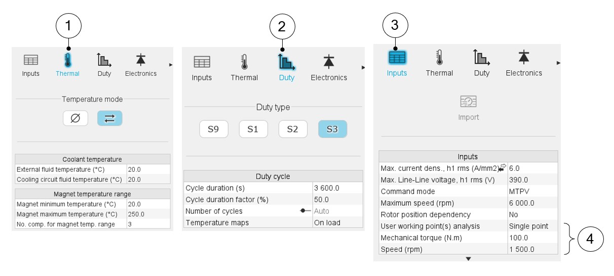

With thermal solving
When thermal solving has been selected in the thermal settings, it is mandatory to define the driving cycle in the Duty Settings by choosing a duty cycle mode: S1, S2, S3 or S9.
Table 3. User working point analysis = Duty cycle
1 The thermal solving is selected in the Thermal – Settings.
Important: This test allows electromagnetic computations with coupled thermal analysis when both the following conditions are met:
  • The type of machine is Synchronous Machine with Permanent Magnets with Inner rotor
  • Iterative thermal solving can be selected.
2 In the Duty -Settings, several duty cycle modes are available: S1, S2, S3 or S9.
3-4 With thermal solving and by considering S1, S2 or S3 only a single working point can be selected. In that case the corresponding load must be defined: The mechanical torque and the speed.
Tip: For additional information, please refer to the section dedicated to the Duty - Settings Duty.
