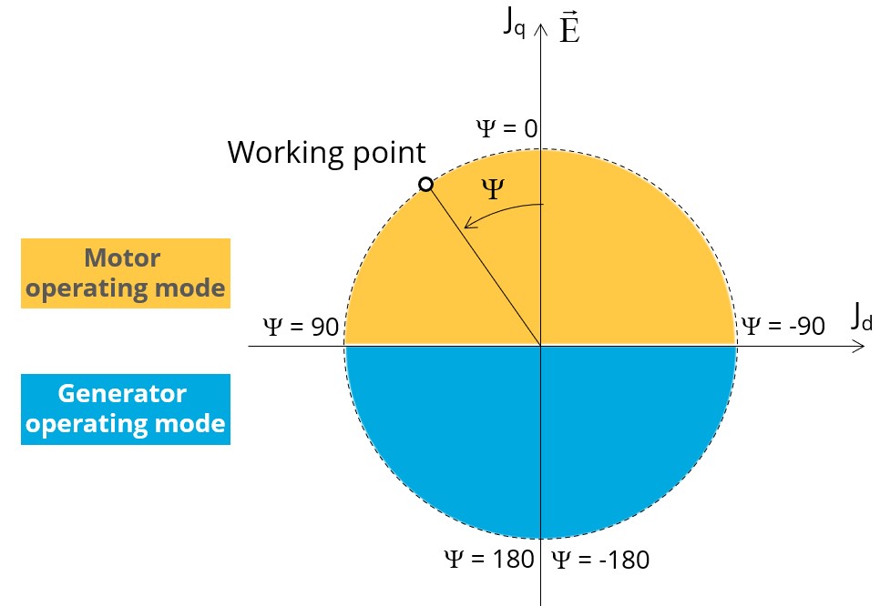

Control angle
Considering the vector diagram shown below, the “Control angle” is the angle between the electromotive force (E) and the electrical current (J) (Ψ = (E, J)).
The default value is 45 degrees. It is an electrical angle. It must be set in a range of -90 to 90 degrees.
This range of values covers all the possible working points in the motor convention. The operating mode is displayed at the head of results.
Note: The sign of results like power depends on both the convention and the operating mode.
