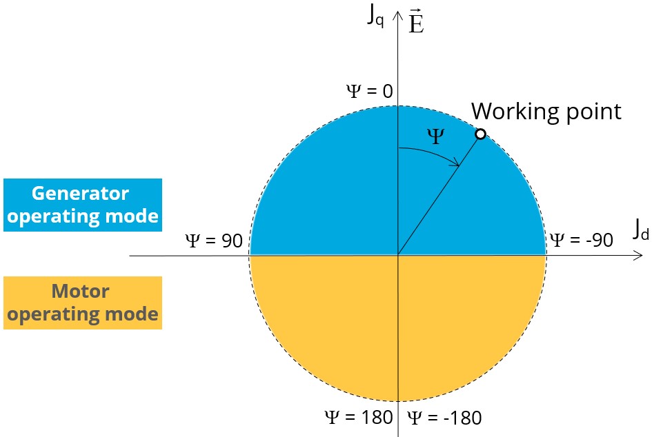

Control angle
Considering the vector diagram shown below, the “Control angle” is the angle between the electromotive force E and the electrical current (J) i.e. (Ψ = (E, J)).
The default value is 45 degrees. It is an electrical angle. It must be set in a range of -180 to 180 degrees.
Figure 1. Definition of the control angle Ψ - Generator convention
