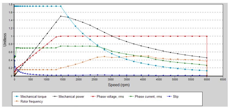

  3. Torque-speed curves
    • Mechanical torque versus speed
    • Efficiency torque versus speed
    • Current versus speed
    • Voltage versus speed
    • Slip versus speed
    • Frequency versus speed
    • Power (Mechanical power, machine electrical power, system electrical power) versus speed
    • Power factor versus speed
    • Losses versus speed (total machine and system, Stator Joule, Rotor Joule, mechanical, power electronics) (iron losses are neglected for the first version of this test)

    • “Normalized base point curves” versus speed
    • “Normalized torque-speed curves” versus speed

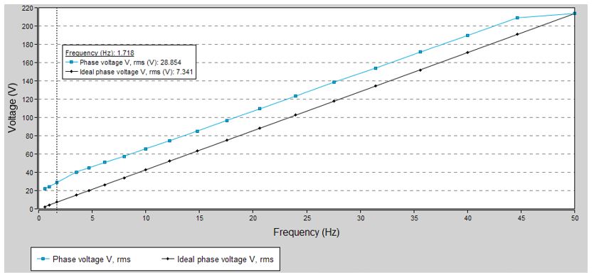

    • “Voltage boost” versus speed (low speed between zero speed and base speed)
