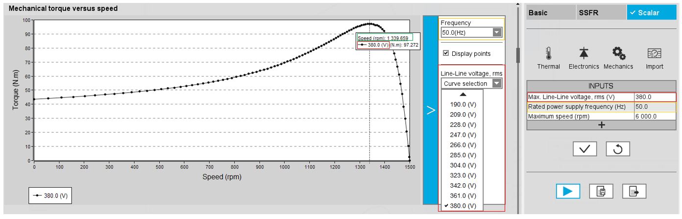

    If you don’t know the value of “Maximum line current, rms”, the following identification process of the “Maximum line current, rms” at the “Base speed point” is recommended:

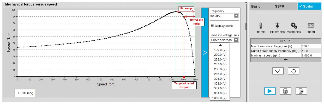

    1. Solve the test “Characterization – Model – Motor – Scalar” (with the same inputs and settings are those to be applied for the test “Performance mapping – Sine wave – Motor – Efficiency map scalar).
    2. From the “Mechanical torque versus speed” curve, select the “Rated power supply frequency value” (Yellow box on the following picture), and the “Max. Line-Line voltage value” (Red box on the following picture)
      “Mechanical torque versus speed” curve, selection of the “Rated power supply frequency value”
    3. Identify the speed at the break down torque (Green box on the previous picture)

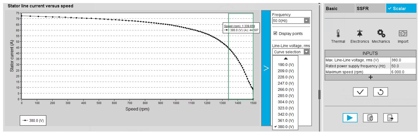

    4. Following the previous steps, select the maximum current value you want to target at the base speed point.
      The value of current selected must be between the speed at break down torque and the maximum speed (green box on the next picture)
    From the “Stator line current versus speed” curve, selection of the maximum current value

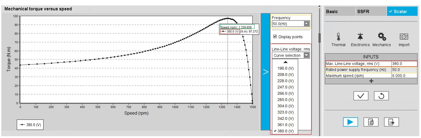

    If the value of “Maximum current density, rms” is unknown, the following identification process of the “Maximum current density, rms” at the “Base speed point” is recommended:
    1. Solve the test “Characterization – Model – Motor – Scalar” (with the same inputs and settings are those to be applied for the test “Performance mapping – Sine wave – Motor – Efficiency map scalar”.
    2. From the “Mechanical torque versus speed” curve, select the “Rated power supply frequency value” (Yellow box on the following picture) and the “Max. Line-Line voltage value” (Red box on the following picture)
      From the “Mechanical torque versus speed” curve, selection of the rated power supply frequency value
      The value of current selected must be between the speed at break down torque and the maximum speed (green box on the next picture).

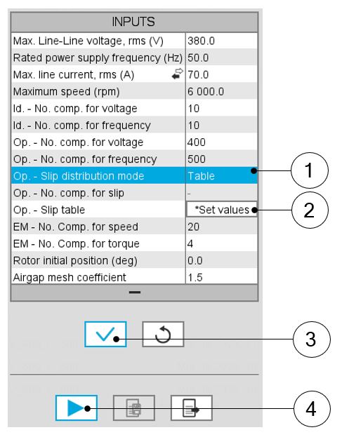

    Slip distribution mode = Table
    1 Select the “Table” option.
    2
    Click the button “Set values” of the field “Slip table” to open a dialog box defining the list of slips to be considered.
    Refer to the next illustration which shows how to fill the Slip table.
    3 Button to validate and consider the user inputs
    4 Button to run the computation
