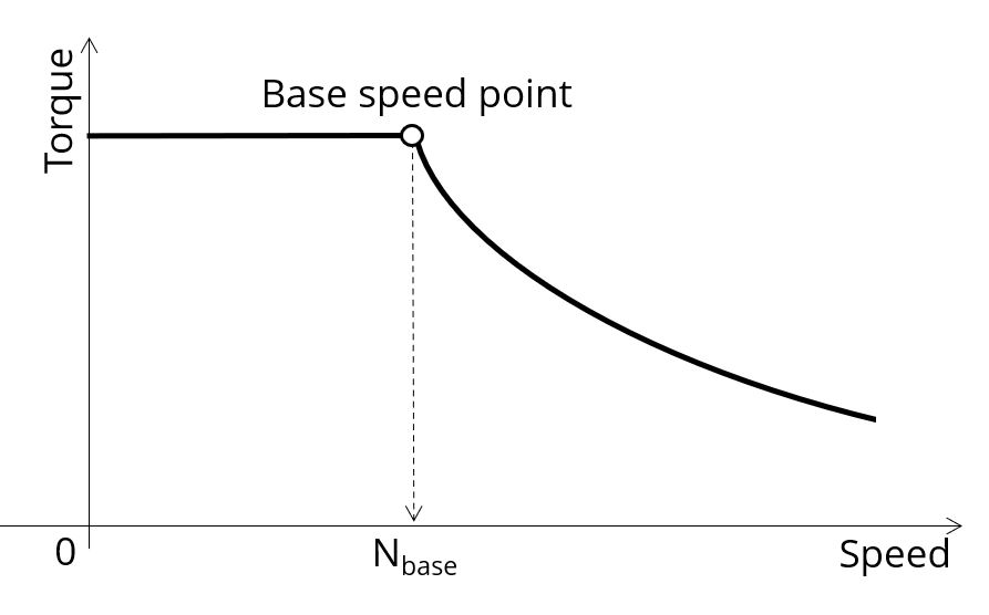

Characterization of the corner point on the torque-speed curve
In the results, the performance of the machine at the base point (base speed point) and the maximum speed (maximum speed point), set by the user are presented.

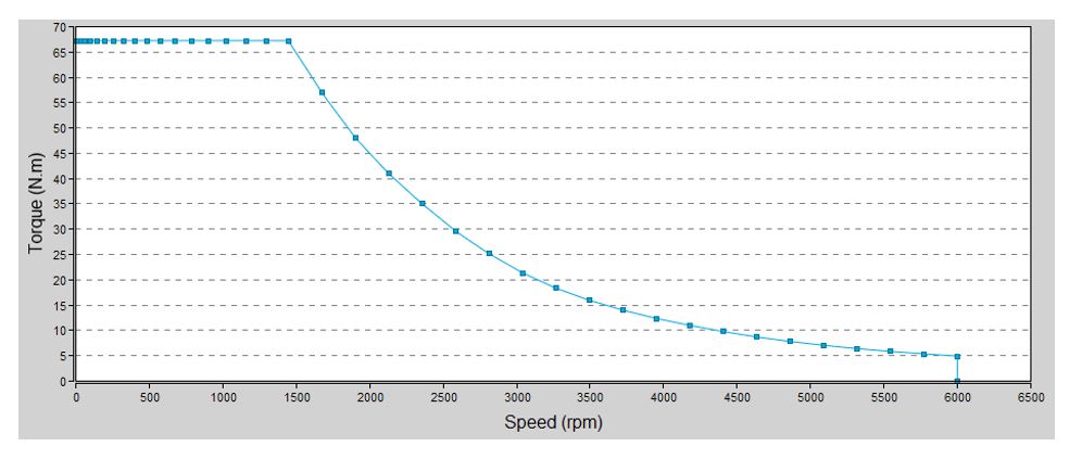

Mechanical torque versus speed - Example

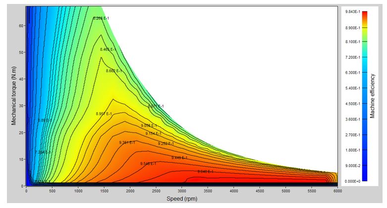

Efficiency in torque-speed area - Example
