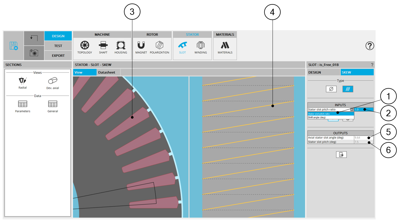

SLOT – SKEW design area
1 Selection of the STATOR subset: SLOT panel (Click on the icon SLOT)
2 Skew tab indicates the tool to define the slot skew angle
3 Visualization of the machine radial view to visualize the slot skew
4 Visualization of the stator developed view to visualize the slot skew
5 Choices to define a skew: None – Continuous (Continuous in our example)
6 Skew inputs to be defined
7 Buttons to validate the inputs (Pressing the “enter key” twice applies inputs too).
8 Buttons to restore the default input values.
9 Skew outputs (read only)
10 Button to export the skew data into *.txt or *.xls files.
2. Set a skew angle
How to set a skew angle?
1 Choose the definition mode of the skew: Stator slot – Shift angle
2 Definition of the skew angle depending of the definition mode
3 Visualization of the chosen skew angle on the machine radial view
4 Visualization of the equivalent axial slot angle on the rotor developed view
5 Equivalent axial stator slot angle (read only)
6 Equivalent stator slot pitch (read only)
Note: The user can add a skew angle on the rotor or on the stator. If a skew is already defined in the rotor when setting a skew on the stator, the rotor skewing will be automatically reset to “None”.
