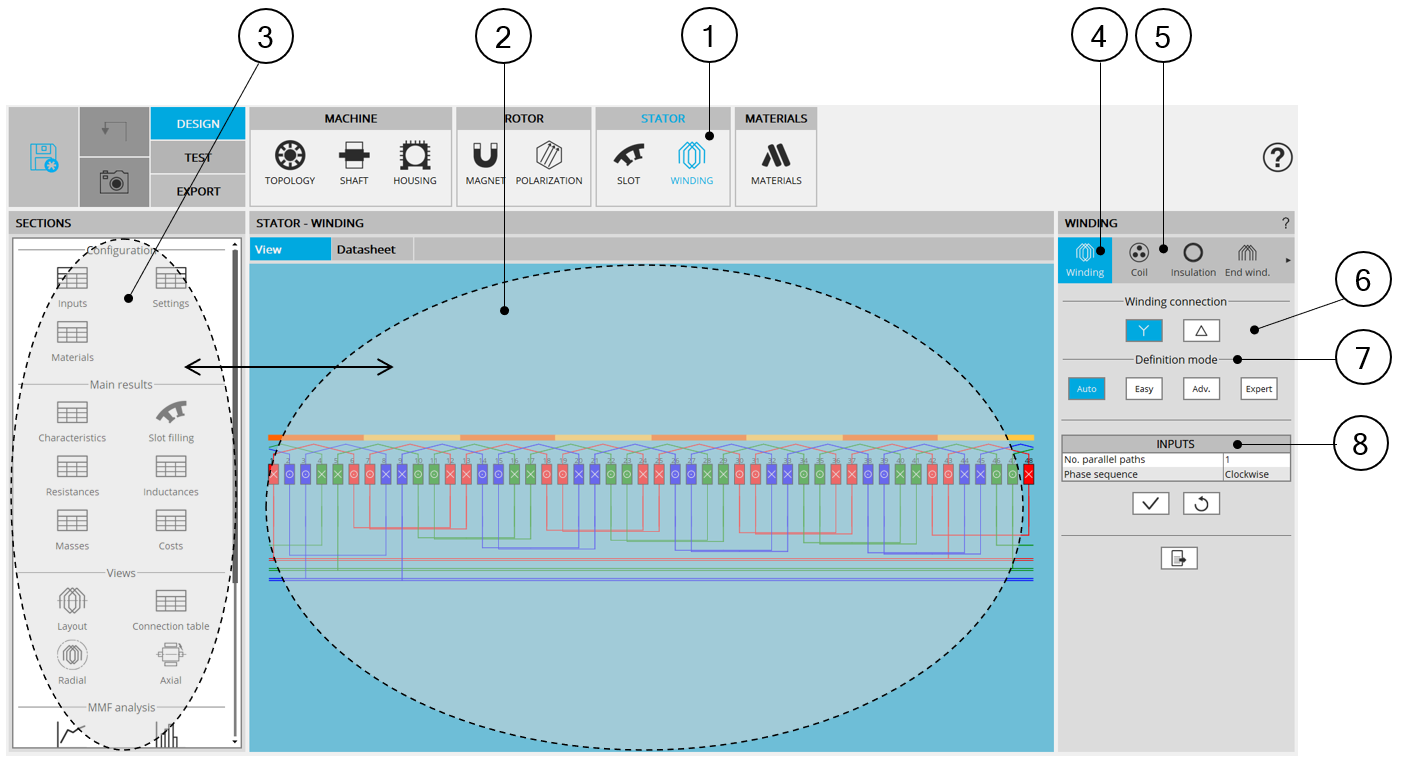

WINDING design area - Overview | |
1 | Selection of the STATOR subset: WINDING panel (Click on the icon WINDING) |
2 | Once a winding is defined, corresponding results are automatically
displayed in form of a winding report. Visualization of the winding
characteristics (inputs, settings, materials, etc) is possible. Scrollbars allow browsing the whole document rapidly and having an overview of all the results. Using scrollbars, complete data can be accessed and visualized. |
3 | Shortcuts for displaying the corresponding chapter of the winding report. |
4 | Winding settings allow describing the winding architecture. |
5 | Winding settings allow describing the winding: |
6 | Choice of the winding connection: Y (Wye) or D (Delta). |
7 | Four modes allow defining and building the winding architecture . |
Auto | Automatic mode used by default. |
Easy | Easy mode, to choose solution among what is proposed. |
Adv. | Advanced mode, to allow the user to define his own input parameters. |
Expert | Expert mode to set the connection table. |
8 | User input parameter field to enter the value according to the considered mode. |

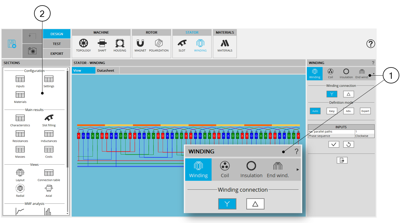

Scrolling selection bar – Winding environment | |
1 | Selection bar where Winding, Coil, End-winding and X-Factor sections can be selected |
2 | Section data can be reached thanks to shortcuts |
