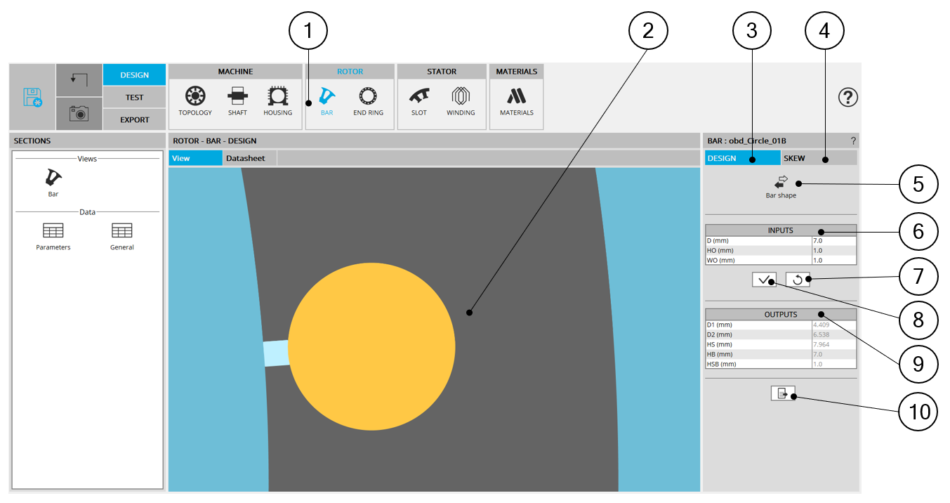

BAR – DESIGN - design area | |
1 | Selection of the ROTOR subset: BAR panel (Click on the icon BAR) |
2 | Visualization of the motor radial view with the bar topology and dimensions. |
3 | DESIGN tab indicates the tools to define the bar topology and parameter
values Note: By default, DESIGN tab is
selected
4 | SKEW tab indicates the tools to define the bar skew angle |
5 | "Bar shape" button allows accessing to the bar libraries to change the
bar topology. See additional information below. |
6 | User input parameter fields to enter the values. |
7 | Button to restore default input values. |
8 | Button to apply inputs. Pressing the “enter key” twice applies inputs too. |
9 | Output parameters (read only data) to complete the description of the topology. |
10 | Icon to export bar data into *.txt or *.xls files. |
