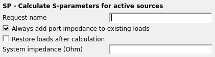

This card defines an S-parameter (S-matrix) request for active sources.
On the Request tab, in the Configurations
group, click the
S-parameter (SP)
icon.
Figure 1. The SP - Calculate S-parameters for active sources dialog .
Parameters:
- Request name
- The name of the request.
- Always add port impedance to existing loads
- When S-parameters are computed, each port is automatically loaded by Feko with the S-parameter reference impedance of the port. If this option is checked, and the user has manually defined a load at a port, then the S-parameter load will be added to the existing load at the port. If this option is not checked, then Feko will automatically add the S-parameter reference loads at the various ports, but possible user defined loads of the same load type (see discussion below) will be overwritten (not added) at these ports.
- Restore loads after calculation
- As discussed above, Feko automatically adds loads to ports when computing S-parameters. With this option the behaviour can be controlled after the SP card processing is finished. When this option is enabled, the loads that were automatically added will be removed, and the load situation (for instance for a subsequent far field request) is the same as if the SP card was not used. Otherwise, all the loads as set during the SP card processing will remain in place afterwards.
- System impedance
- The reference impedance in Ohm. This is used for all sources for which no impedance value is specified when defining the source. If this field is empty, it defaults to 50. Note that for waveguide sources (AW card) S-parameters are always related to the corresponding waveguide impedance.
