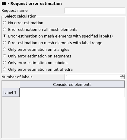

The EE card requests an a-posteriori error indicator whereby Feko can test the solution against an unconstrained physical test. The result is to give an indication of the region where local mesh refinement should be considered.
On the Request tab, in the Solution requests
group, click the Error estimation
(EE) icon.
![](../../../../../../images/feko/user_guide/editfeko_cards/dialog_ee.png)
Figure 1. The EE - Request error estimation dialog.
Parameters:
- Request name
- The name of the request.
- No error estimation
- No error estimation output.
- Error estimation on all mesh elements
- Output error estimation on all mesh elements.
- Error estimation on mesh elements with specified label(s)
- Output error estimation on mesh elements with labels specified by the user.
- Error estimation on mesh elements with label range
- Output error estimation in the label range starting on Start label and ending on End label.
- Only error estimation on triangles
- Output only error estimation on triangles.
- Only error estimation on segments
- Output only error estimation on segments.
- Only error estimation on cuboids
- Output only error estimation on cuboids.
- Only error estimation on tetrahedra
- Output only error estimation on tetrahedra.
