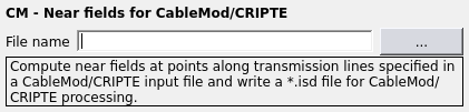

In the Request tab, in the Solution requests
group, click the Cable fields (CM)
icon.
![](../../../../../../images/feko/user_guide/editfeko_cards/dialog_cm.png)
Figure 1. The CM - Near fields for CableMod/CRIPTE dialog.

- File name
- The name of the .rsd file created by CableMod, CRIPTE or PCBMod (enclosed in double quotation marks and starting at or after column 91)
The .rsd file contains geometry of the line. With the CM card Feko calculates the electric and magnetic nearfield at points along the line and write these to a .isd file for further processing by CableMod,CRIPTE or PCBMod. (The .isd file also contains additional data required by CableMod, CRIPTE or PCBMod, for example, the frequencies that were used during the solution.)
The complete geometry (without the transmission line) as well as the frequency and excitation(Ax cards) must be defined in Feko.
