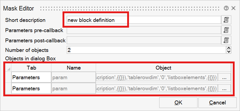

  3. Edit the mask of the super block. Update the Number of objects to 2 or more based on the requirements, as shown in the image below.
  4. For each parameter, define the name and the properties. Click the ... button to open the Parameters Creator tab.
    In this example, the following parameters are defined. The first one defines the Target and must be present. The base frequency The others are specific to Raspberry PI target.

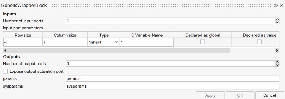

Place a generic wrapper block from the WrapperCodeGenerator library in the diagram and define the parameters as shown in the image below.
This sets the number of inputs of the block to one. The block can then be placed in a super block defining the serial write block. The values of the parameters params and sysparams are defined by variables bearing the same names and defined in the super block context. The super block can then be named after the desired name for the write block. Finally, the super block is masked, and its default parameter values specified. The masked super block can now be placed in the library. The following figure shows the full content of the block RPiSerialWrite.
The variables params and sysparams are obtained in the context by calling the wrapper library function, RaspberryPiWrapperLIB, to be developed. The variable _params in the context of the masked super block contains the mask parameter values. The block parameters, along with the name of the block, are used to call the library function, which in return, provides the block params and sysparams parameters.

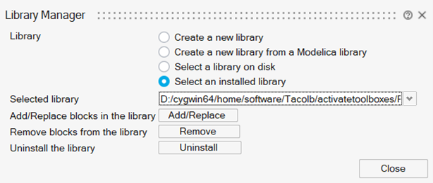

  1. Open the library manager and select the library being developed.
  2. Select the block to add to the library.
  3. Use the Add/Replace menu to add the new block to the library.
This operation adds the selected block to the library and reloads the updated library. The new block should be visible in the palette browser and can be dragged and dropped in any model.
