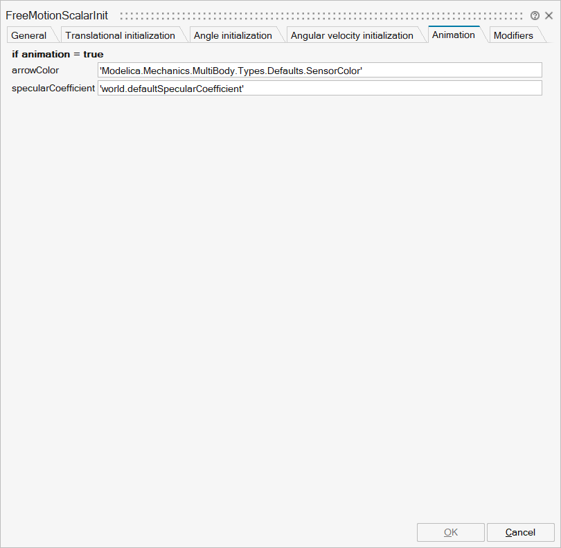

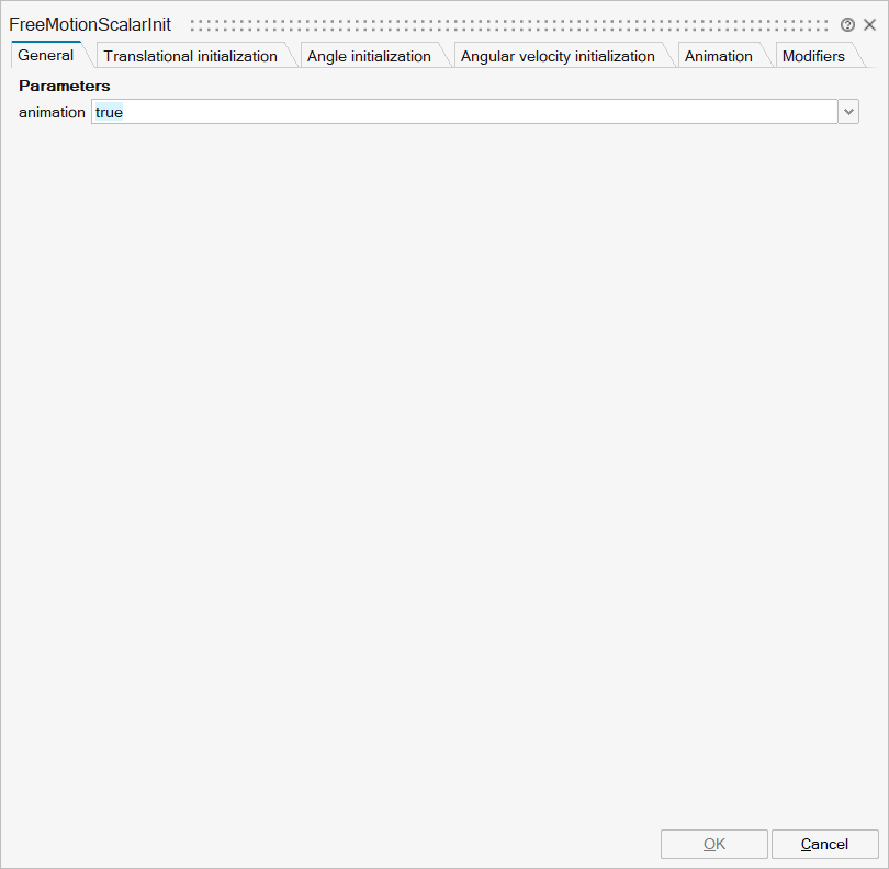

mo_animation | animation | = true, if animation shall be enabled (show arrow from frame_a to frame_b) | Scalar | true |

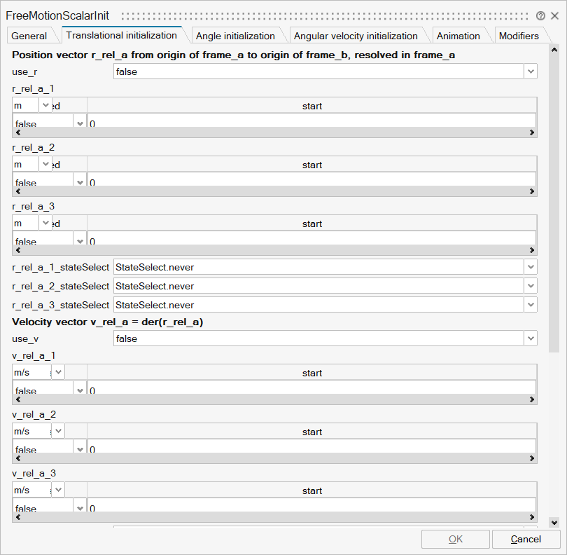

mo_use_r | use_r | = true, if r_rel_a shall be used | Scalar | true |
mo_r_rel_a_1 | r_rel_a_1 | r_rel_a_1 | Structure | |
mo_r_rel_a_1/fixed | fixed | Cell of scalars | true | |
mo_r_rel_a_1/start | start | Cell of scalars | ||
mo_r_rel_a_2 | r_rel_a_2 | r_rel_a_2 | Structure | |
mo_r_rel_a_2/fixed | fixed | Cell of scalars | true | |
mo_r_rel_a_2/start | start | Cell of scalars | ||
mo_r_rel_a_3 | r_rel_a_3 | r_rel_a_3 | Structure | |
mo_r_rel_a_3/fixed | fixed | Cell of scalars | true | |
mo_r_rel_a_3/start | start | Cell of scalars | ||
mo_r_rel_a_1_stateSelect | r_rel_a_1_stateSelect | StateSelect of r_rel_a[1] | Structure | |
mo_r_rel_a_1_stateSelect/choice1 | StateSelect.never | Number | 0 | |
mo_r_rel_a_1_stateSelect/choice2 | StateSelect.avoid | Number | 0 | |
mo_r_rel_a_1_stateSelect/choice3 | StateSelect.default | Number | 0 | |
mo_r_rel_a_1_stateSelect/choice4 | StateSelect.prefer | Number | 0 | |
mo_r_rel_a_1_stateSelect/choice5 | StateSelect.always | Number | 0 | |
mo_r_rel_a_2_stateSelect | r_rel_a_2_stateSelect | StateSelect of r_rel_a[2] | Structure | |
mo_r_rel_a_2_stateSelect/choice1 | StateSelect.never | Number | 0 | |
mo_r_rel_a_2_stateSelect/choice2 | StateSelect.avoid | Number | 0 | |
mo_r_rel_a_2_stateSelect/choice3 | StateSelect.default | Number | 0 | |
mo_r_rel_a_2_stateSelect/choice4 | StateSelect.prefer | Number | 0 | |
mo_r_rel_a_2_stateSelect/choice5 | StateSelect.always | Number | 0 | |
mo_r_rel_a_3_stateSelect | r_rel_a_3_stateSelect | StateSelect of r_rel_a[3] | Structure | |
mo_r_rel_a_3_stateSelect/choice1 | StateSelect.never | Number | 0 | |
mo_r_rel_a_3_stateSelect/choice2 | StateSelect.avoid | Number | 0 | |
mo_r_rel_a_3_stateSelect/choice3 | StateSelect.default | Number | 0 | |
mo_r_rel_a_3_stateSelect/choice4 | StateSelect.prefer | Number | 0 | |
mo_r_rel_a_3_stateSelect/choice5 | StateSelect.always | Number | 0 | |
mo_use_v | use_v | = true, if v_rel_a shall be used | Scalar | true |
mo_v_rel_a_1 | v_rel_a_1 | v_rel_a_1 | Structure | |
mo_v_rel_a_1/fixed | fixed | Cell of scalars | true | |
mo_v_rel_a_1/start | start | Cell of scalars | ||
mo_v_rel_a_2 | v_rel_a_2 | v_rel_a_2 | Structure | |
mo_v_rel_a_2/fixed | fixed | Cell of scalars | true | |
mo_v_rel_a_2/start | start | Cell of scalars | ||
mo_v_rel_a_3 | v_rel_a_3 | v_rel_a_3 | Structure | |
mo_v_rel_a_3/fixed | fixed | Cell of scalars | true | |
mo_v_rel_a_3/start | start | Cell of scalars | ||
mo_v_rel_a_1_stateSelect | v_rel_a_1_stateSelect | StateSelect of v_rel_a[1] | Structure | |
mo_v_rel_a_1_stateSelect/choice1 | StateSelect.never | Number | 0 | |
mo_v_rel_a_1_stateSelect/choice2 | StateSelect.avoid | Number | 0 | |
mo_v_rel_a_1_stateSelect/choice3 | StateSelect.default | Number | 0 | |
mo_v_rel_a_1_stateSelect/choice4 | StateSelect.prefer | Number | 0 | |
mo_v_rel_a_1_stateSelect/choice5 | StateSelect.always | Number | 0 | |
mo_v_rel_a_2_stateSelect | v_rel_a_2_stateSelect | StateSelect of v_rel_a[2] | Structure | |
mo_v_rel_a_2_stateSelect/choice1 | StateSelect.never | Number | 0 | |
mo_v_rel_a_2_stateSelect/choice2 | StateSelect.avoid | Number | 0 | |
mo_v_rel_a_2_stateSelect/choice3 | StateSelect.default | Number | 0 | |
mo_v_rel_a_2_stateSelect/choice4 | StateSelect.prefer | Number | 0 | |
mo_v_rel_a_2_stateSelect/choice5 | StateSelect.always | Number | 0 | |
mo_v_rel_a_3_stateSelect | v_rel_a_3_stateSelect | StateSelect of v_rel_a[3] | Structure | |
mo_v_rel_a_3_stateSelect/choice1 | StateSelect.never | Number | 0 | |
mo_v_rel_a_3_stateSelect/choice2 | StateSelect.avoid | Number | 0 | |
mo_v_rel_a_3_stateSelect/choice3 | StateSelect.default | Number | 0 | |
mo_v_rel_a_3_stateSelect/choice4 | StateSelect.prefer | Number | 0 | |
mo_v_rel_a_3_stateSelect/choice5 | StateSelect.always | Number | 0 | |
mo_use_a | use_a | = true, if a_rel_a shall be used | Scalar | true |
mo_a_rel_a_1 | a_rel_a_1 | a_rel_a_1 | Structure | |
mo_a_rel_a_1/fixed | fixed | Cell of scalars | true | |
mo_a_rel_a_1/start | start | Cell of scalars | ||
mo_a_rel_a_2 | a_rel_a_2 | a_rel_a_2 | Structure | |
mo_a_rel_a_2/fixed | fixed | Cell of scalars | true | |
mo_a_rel_a_2/start | start | Cell of scalars | ||
mo_a_rel_a_3 | a_rel_a_3 | a_rel_a_3 | Structure | |
mo_a_rel_a_3/fixed | fixed | Cell of scalars | true | |
mo_a_rel_a_3/start | start | Cell of scalars |

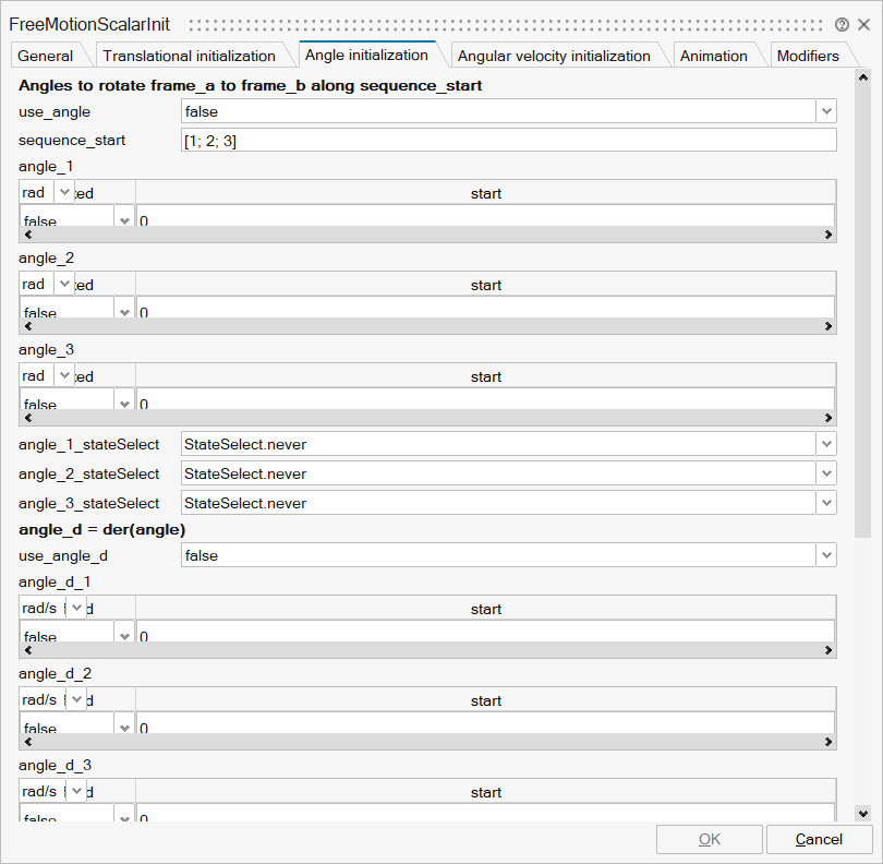

mo_use_angle | use_angle | = true, if angle shall be used | Scalar | true |
mo_sequence_start | sequence_start | Sequence of angle rotations | Vector of size 3 | |
mo_angle_1 | angle_1 | angle_1 | Structure | |
mo_angle_1/fixed | fixed | Cell of scalars | true | |
mo_angle_1/start | start | Cell of scalars | ||
mo_angle_2 | angle_2 | angle_2 | Structure | |
mo_angle_2/fixed | fixed | Cell of scalars | true | |
mo_angle_2/start | start | Cell of scalars | ||
mo_angle_3 | angle_3 | angle_3 | Structure | |
mo_angle_3/fixed | fixed | Cell of scalars | true | |
mo_angle_3/start | start | Cell of scalars | ||
mo_angle_1_stateSelect | angle_1_stateSelect | StateSelect of angle_1 | Structure | |
mo_angle_1_stateSelect/choice1 | StateSelect.never | Number | 0 | |
mo_angle_1_stateSelect/choice2 | StateSelect.avoid | Number | 0 | |
mo_angle_1_stateSelect/choice3 | StateSelect.default | Number | 0 | |
mo_angle_1_stateSelect/choice4 | StateSelect.prefer | Number | 0 | |
mo_angle_1_stateSelect/choice5 | StateSelect.always | Number | 0 | |
mo_angle_2_stateSelect | angle_2_stateSelect | StateSelect of angle_2 | Structure | |
mo_angle_2_stateSelect/choice1 | StateSelect.never | Number | 0 | |
mo_angle_2_stateSelect/choice2 | StateSelect.avoid | Number | 0 | |
mo_angle_2_stateSelect/choice3 | StateSelect.default | Number | 0 | |
mo_angle_2_stateSelect/choice4 | StateSelect.prefer | Number | 0 | |
mo_angle_2_stateSelect/choice5 | StateSelect.always | Number | 0 | |
mo_angle_3_stateSelect | angle_3_stateSelect | StateSelect of angle_3 | Structure | |
mo_angle_3_stateSelect/choice1 | StateSelect.never | Number | 0 | |
mo_angle_3_stateSelect/choice2 | StateSelect.avoid | Number | 0 | |
mo_angle_3_stateSelect/choice3 | StateSelect.default | Number | 0 | |
mo_angle_3_stateSelect/choice4 | StateSelect.prefer | Number | 0 | |
mo_angle_3_stateSelect/choice5 | StateSelect.always | Number | 0 | |
mo_use_angle_d | use_angle_d | = true, if angle_d shall be used | Scalar | true |
mo_angle_d_1 | angle_d_1 | angle_d_1 | Structure | |
mo_angle_d_1/fixed | fixed | Cell of scalars | true | |
mo_angle_d_1/start | start | Cell of scalars | ||
mo_angle_d_2 | angle_d_2 | angle_d_2 | Structure | |
mo_angle_d_2/fixed | fixed | Cell of scalars | true | |
mo_angle_d_2/start | start | Cell of scalars | ||
mo_angle_d_3 | angle_d_3 | angle_d_3 | Structure | |
mo_angle_d_3/fixed | fixed | Cell of scalars | true | |
mo_angle_d_3/start | start | Cell of scalars | ||
mo_angle_d_1_stateSelect | angle_d_1_stateSelect | StateSelect of angle_d_1 | Structure | |
mo_angle_d_1_stateSelect/choice1 | StateSelect.never | Number | 0 | |
mo_angle_d_1_stateSelect/choice2 | StateSelect.avoid | Number | 0 | |
mo_angle_d_1_stateSelect/choice3 | StateSelect.default | Number | 0 | |
mo_angle_d_1_stateSelect/choice4 | StateSelect.prefer | Number | 0 | |
mo_angle_d_1_stateSelect/choice5 | StateSelect.always | Number | 0 | |
mo_angle_d_2_stateSelect | angle_d_2_stateSelect | StateSelect of angle_d_2 | Structure | |
mo_angle_d_2_stateSelect/choice1 | StateSelect.never | Number | 0 | |
mo_angle_d_2_stateSelect/choice2 | StateSelect.avoid | Number | 0 | |
mo_angle_d_2_stateSelect/choice3 | StateSelect.default | Number | 0 | |
mo_angle_d_2_stateSelect/choice4 | StateSelect.prefer | Number | 0 | |
mo_angle_d_2_stateSelect/choice5 | StateSelect.always | Number | 0 | |
mo_angle_d_3_stateSelect | angle_d_3_stateSelect | StateSelect of angle_d_3 | Structure | |
mo_angle_d_3_stateSelect/choice1 | StateSelect.never | Number | 0 | |
mo_angle_d_3_stateSelect/choice2 | StateSelect.avoid | Number | 0 | |
mo_angle_d_3_stateSelect/choice3 | StateSelect.default | Number | 0 | |
mo_angle_d_3_stateSelect/choice4 | StateSelect.prefer | Number | 0 | |
mo_angle_d_3_stateSelect/choice5 | StateSelect.always | Number | 0 | |
mo_use_angle_dd | use_angle_dd | = true, if angle_dd shall be used | Scalar | true |
mo_angle_dd_1 | angle_dd_1 | angle_dd_1 | Structure | |
mo_angle_dd_1/fixed | fixed | Cell of scalars | true | |
mo_angle_dd_1/start | start | Cell of scalars | ||
mo_angle_dd_2 | angle_dd_2 | angle_dd_2 | Structure | |
mo_angle_dd_2/fixed | fixed | Cell of scalars | true | |
mo_angle_dd_2/start | start | Cell of scalars | ||
mo_angle_dd_3 | angle_dd_3 | angle_dd_3 | Structure | |
mo_angle_dd_3/fixed | fixed | Cell of scalars | true | |
mo_angle_dd_3/start | start | Cell of scalars |

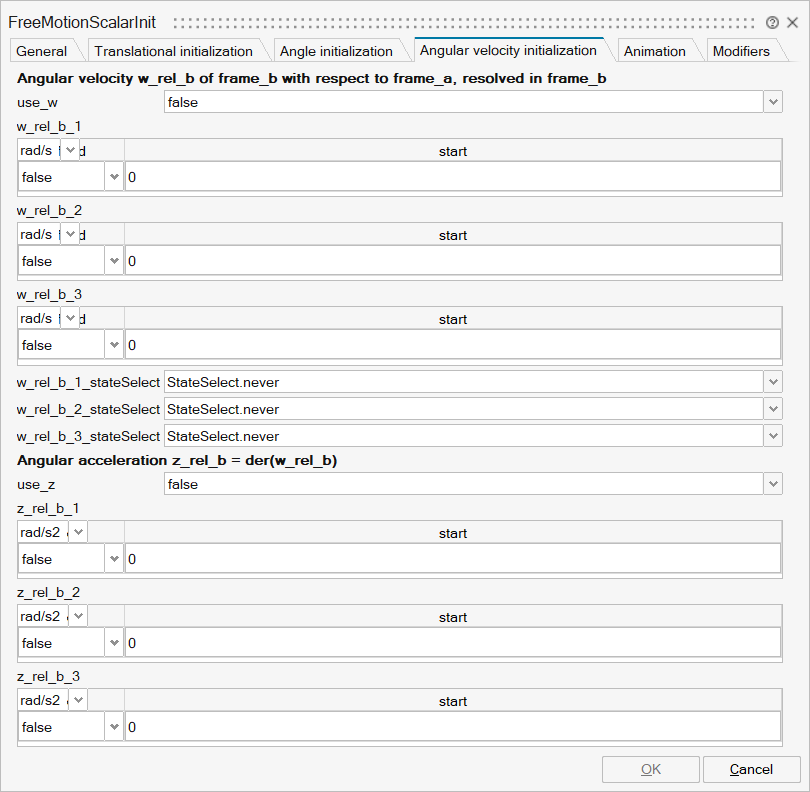

mo_use_w | use_w | = true, if w_rel_b shall be used | Scalar | true |
mo_w_rel_b_1 | w_rel_b_1 | w_rel_b_1 | Structure | |
mo_w_rel_b_1/fixed | fixed | Cell of scalars | true | |
mo_w_rel_b_1/start | start | Cell of scalars | ||
mo_w_rel_b_2 | w_rel_b_2 | w_rel_b_2 | Structure | |
mo_w_rel_b_2/fixed | fixed | Cell of scalars | true | |
mo_w_rel_b_2/start | start | Cell of scalars | ||
mo_w_rel_b_3 | w_rel_b_3 | w_rel_b_3 | Structure | |
mo_w_rel_b_3/fixed | fixed | Cell of scalars | true | |
mo_w_rel_b_3/start | start | Cell of scalars | ||
mo_w_rel_b_1_stateSelect | w_rel_b_1_stateSelect | StateSelect of w_rel_b[1] | Structure | |
mo_w_rel_b_1_stateSelect/choice1 | StateSelect.never | Number | 0 | |
mo_w_rel_b_1_stateSelect/choice2 | StateSelect.avoid | Number | 0 | |
mo_w_rel_b_1_stateSelect/choice3 | StateSelect.default | Number | 0 | |
mo_w_rel_b_1_stateSelect/choice4 | StateSelect.prefer | Number | 0 | |
mo_w_rel_b_1_stateSelect/choice5 | StateSelect.always | Number | 0 | |
mo_w_rel_b_2_stateSelect | w_rel_b_2_stateSelect | StateSelect of w_rel_b[2] | Structure | |
mo_w_rel_b_2_stateSelect/choice1 | StateSelect.never | Number | 0 | |
mo_w_rel_b_2_stateSelect/choice2 | StateSelect.avoid | Number | 0 | |
mo_w_rel_b_2_stateSelect/choice3 | StateSelect.default | Number | 0 | |
mo_w_rel_b_2_stateSelect/choice4 | StateSelect.prefer | Number | 0 | |
mo_w_rel_b_2_stateSelect/choice5 | StateSelect.always | Number | 0 | |
mo_w_rel_b_3_stateSelect | w_rel_b_3_stateSelect | StateSelect of w_rel_b[3] | Structure | |
mo_w_rel_b_3_stateSelect/choice1 | StateSelect.never | Number | 0 | |
mo_w_rel_b_3_stateSelect/choice2 | StateSelect.avoid | Number | 0 | |
mo_w_rel_b_3_stateSelect/choice3 | StateSelect.default | Number | 0 | |
mo_w_rel_b_3_stateSelect/choice4 | StateSelect.prefer | Number | 0 | |
mo_w_rel_b_3_stateSelect/choice5 | StateSelect.always | Number | 0 | |
mo_use_z | use_z | = true, if z_rel_b shall be used | Scalar | true |
mo_z_rel_b_1 | z_rel_b_1 | z_rel_b_1 | Structure | |
mo_z_rel_b_1/fixed | fixed | Cell of scalars | true | |
mo_z_rel_b_1/start | start | Cell of scalars | ||
mo_z_rel_b_2 | z_rel_b_2 | z_rel_b_2 | Structure | |
mo_z_rel_b_2/fixed | fixed | Cell of scalars | true | |
mo_z_rel_b_2/start | start | Cell of scalars | ||
mo_z_rel_b_3 | z_rel_b_3 | z_rel_b_3 | Structure | |
mo_z_rel_b_3/fixed | fixed | Cell of scalars | true | |
mo_z_rel_b_3/start | start | Cell of scalars |
