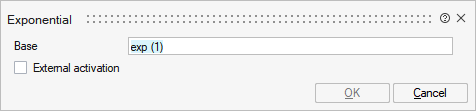

base
Base
The block implements the power function given this parameter.
