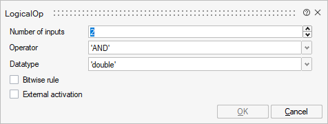

LogicalOp_0
nin
Number of inputs
Number of inputs of the block. Integer value.
The operator NOT only supports one input.
rule
Operator
Logical operators supported by the LogicalOp block are : AND, OR, NAND, NOR, XOR, NOT.
'AND'
'OR'
'NAND'
'NOR'
'XOR'
'XNOR'
'NOT'
Datatype
Datatype
Defines the datatype of the input and output.
Supported types are : double, int32, int16, int8, uint32, uint16, uint8, inherit.
'double'
'int32'
'int16'
'int8'
'uint32'
'uint16'
'uint8'
'boolean'
'inherit'
tp
Bitwise rule
If this parameter is set, operators are applied bitwise. It is only applicable to integer inputs.
externalActivation
External activation
nin
Port 3
externalActivation
