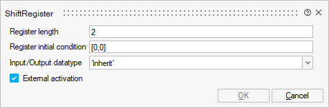

This block implements a FIFO shift register. A shift is performed with every activation of the block. The Register Initial Condition parameter is a matrix that contains in its columns the values originally present in the shift register.
    ShiftRegister
Activate/Dynamical
The ShiftRegister block implements a FIFO shift register. A shift is performed at every activation of the block. The Register Initial Condition parameter is a matrix that contains in its columns the values originally present in the shift register.
ShiftRegister_0
K
Register length
Register length.
z0
Register initial condition
Contains the initial state of the register, stored as [sampleN, sampleN-1, ..., sample1] where N is the register length.
Matrix
type
Input/Output datatype
Defines the data type. Supported data types are: inherit, double, int8, int16, int32, uint8, unit16, uint32.
'double'
'int32'
'int16'
'int8'
'uint32'
'uint16'
'uint8'
'inherit'
externalActivation
External activation
Specifies whether the block receives an external activation or inherits its activation through its regular input ports. When External Activation is selected, an additional activation port is added to the block. By default, external activation is selected.
