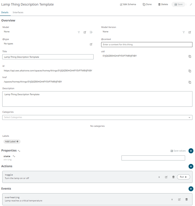

Follow the instructions below to create a new Thing:
Web of Things (WoT) describes a set of standards by the World Wide Web
Consortium (W3C) for the interoperability of different IoT platforms and application
domains. One of the key components specified by the WoT is the Thing
Description. A Thing Description describes a virtual or a physical device
(Thing) expressed in JSON formatting.
Add the following Thing description provided by the W3C:
"@context": "https://www.w3.org/2019/wot/td/v1",
"@type" : "ThingTemplate",
"title": "Lamp Thing Description Template",
"description" : "Lamp Thing Description Template",
"properties": {
"state": {
"description" : "current state of the lamp on|off",
"type": "string",
"readOnly": true
"actions": {
"toggle": {
"description" : "Turn the lamp on or off"
"events": {
"overheating": {
"description" : "Lamp reaches a critical temperature",
"data": {"type": "string"}
