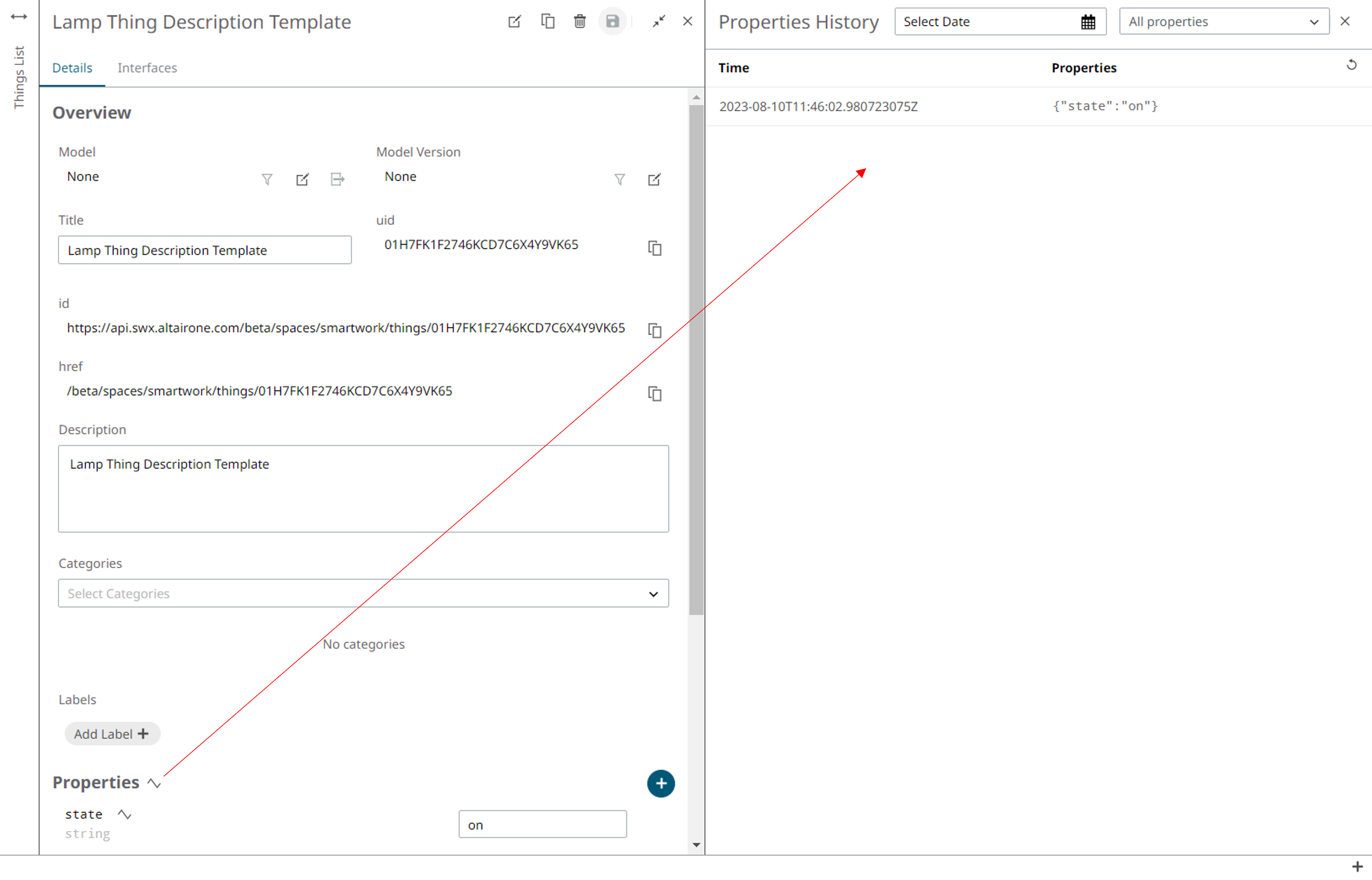

Open the API Inspector.
Update the State property to "On". The request should look like this:
