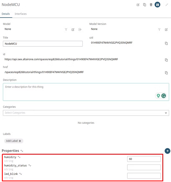

credentials.h: Add your Network ID, Network
password, MQTT username and password.
Note: You can obtain the MQTT username and password from AnythingDB –
Interface tab, by turning on Autogenerate the
username and password and clicking
Save.
Topics_publish.h: Enter your Space name, Category name, Thing ID and Property ID.
Topics_humidity_publish.h: Enter your Space name,

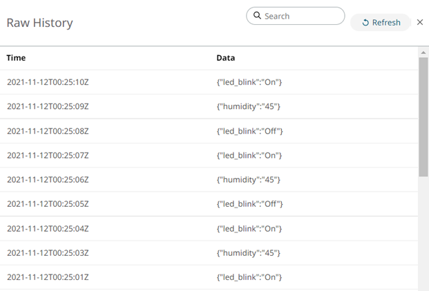

Compile the code and upload it to your ESP8266 device.
Check that the data was received in the Raw History tab, as shown below:
