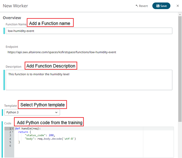

  1. To create a function, click Functions > Workers.
  2. Click New Worker.
  3. Add the Function name as low-humidity-event.
  4. Select the Python 3 template.
  5. Enter the following code. In the provided code, complete with the information required at the beginning. Also, complete the PATH with your own values.

  7. Deploy your function by clicking Save.
    The function is created. This could take a few minutes. The status of your Function will be updated to a Building status and, eventually, it will become Running. At this point, your Function is ready to be called.
  8. You can edit the code in the Code tab as necessary.
    Figure 3.
