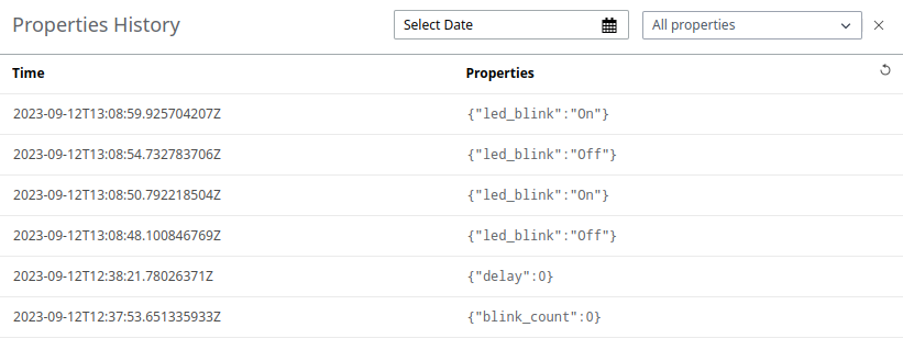

  7. Check that the data was received in the Raw history tab as seen in the image below.
    Figure 3.
