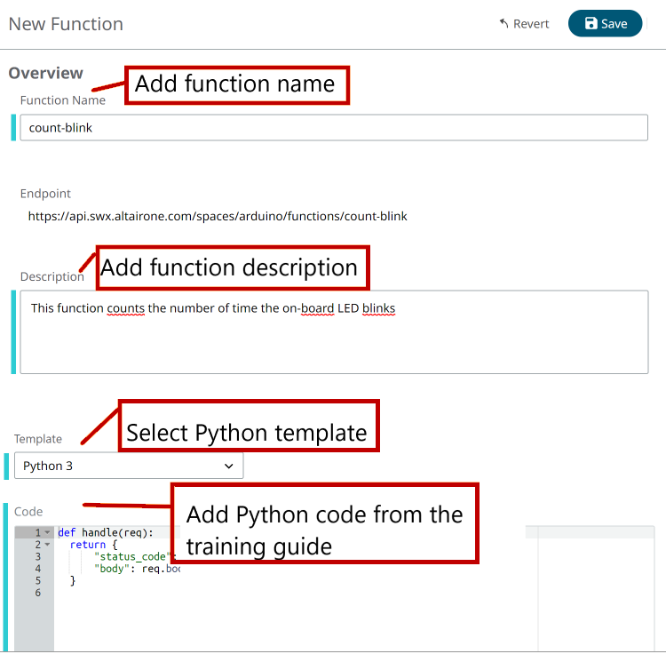

  1. To create a function, click Functions > Workers.
  2. Click New Worker.
  3. Add the Function name as count-blink.
  4. Select the Python 3 template.
  5. Enter the following code. In the provided code, complete with the information required at the beginning. Also, complete the PATH with your own values.

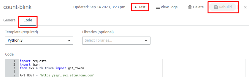

  7. Deploy your function by clicking Save.
    The function is created. This could take a few minutes. The status of your Function will be updated to a Building status and, eventually, it will become Running. At this point, your Function is ready to be called.
  8. You can edit the code in the Code tab as necessary.
    Figure 3.
  9. You can test the function created in the Test tab by sending the input parameters to the function and receive the solution in the test response field. In Test Request Input field enter, {"led_blink": “on”} and click Run.
    The Test Response field shows blink count result.
