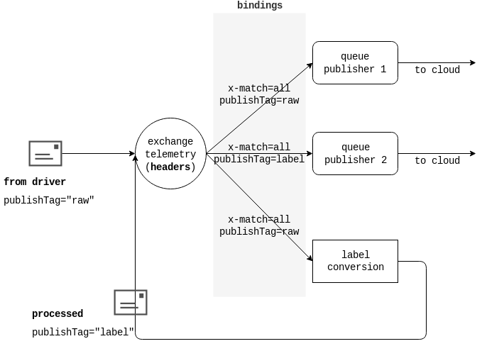

Send or Process Telemetry Data
Telemetry data is published to the ase.exchange.telemetry exchange which is a headers exchange.
See Exchange ase.exchange.telemetry for details on the AMQP user to use and the messages sent.
Queues can be bound for specific types of messages. Services can pick up "raw" messages, process them and publish them to the ase.exchange.telemetry exchange with a new publishTag label.
At the moment connected queues have been tested for:
  • Export MQTT telemetry processing (can process any publishTag)
  • Support label telemetry processing (processes "raw" publishTag, publishes messages back to the exchange using the "label" publishTag header)
  • Meta processing of Thing properties (processes "raw" publishTag)
Both the "publishTag" and "thingID" headers are required.
