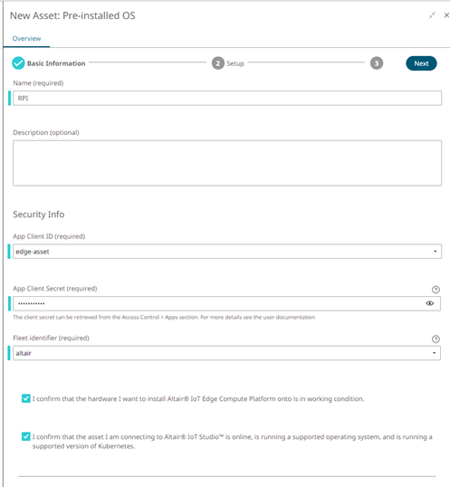

  1. From the Edge Ops menu, click Fleet Management, and then click New Asset .
  2. Set a name for your Asset, and then verify that you have completed the appropriate preparation steps (installing k3s and Ubuntu, etc.)

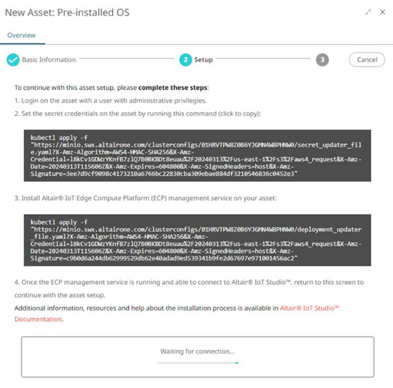

  3. Walk through the management service installation steps. You will need to have access to your hardware's terminal and have administrative privileges on the hardware.
  4. Run the two kubectl commands in your hardware's shell. Simply copy/paste if possible.
  5. When the Asset has successfully established connection with SmartWorks Studio, the following message will appear. Select the Next button to continue.
