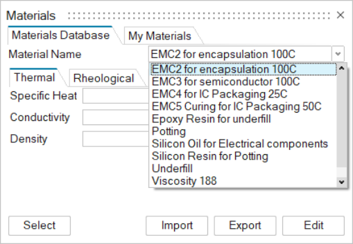

Materials Database Tab
The Materials Database tab lists the materials included with Inspire PolyFoam. The tab also provides access to properties that you can review and modify for each material. You can save any modified materials as new materials and access them and their properties through My Materials tab.
Select a material from the list. The primary properties for the selected material are organized through the Thermal, Rheological, Mechanical, PVT and Curing Kinetics tabs.

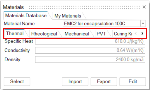

Thermal Tab
The Thermal tab includes the following material properties:
Property Description
Specific Heat Specific Heat = energy per unit of mass per degree of temperature change.
Conductivity In this case, we are measuring thermal conductivity, where Conductivity = Watts per unit of distance per degree of temperature change.
Density Density = units of mass per units of volume

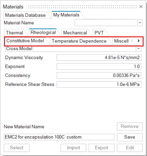

Rheological Tab
The Rheological tab includes a second row of tabs to define Constitutive Model, Temperature Dependence, and Miscellaneous properties for the materials.
The Constitutive Model subtab includes a dropdown menu listing the following constitutive models:
  • Carreau-Yasuda
  • Cross Castro-Macoscko Model
  • Cross Model
  • Herschel-Bulkley
  • Modified Cross Model
  • None
  • Power Law
Each constitutive model includes fields for its required inputs.
The Temperature Dependence subtab includes a dropdown menu listing the following temperature dependence models:
  • Exp(-Beta(T-Tref)): Simple exponential decay with temperature.
  • Exp(Q/RT)): Arrhenius model--viscosity follows thermally activated flow.
  • WLF: Williams-Landel_Ferry model--large viscosity change near glass transition.
Each temperature dependence model includes fields for its required inputs.
