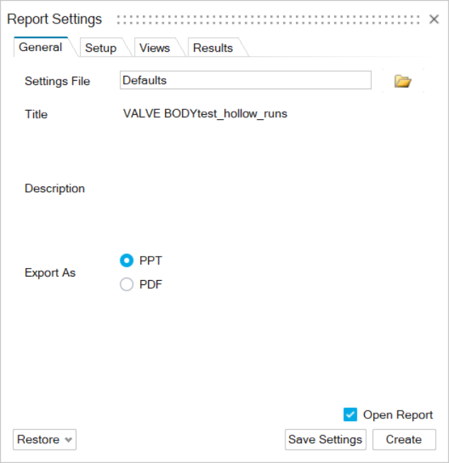

                On the General tab:

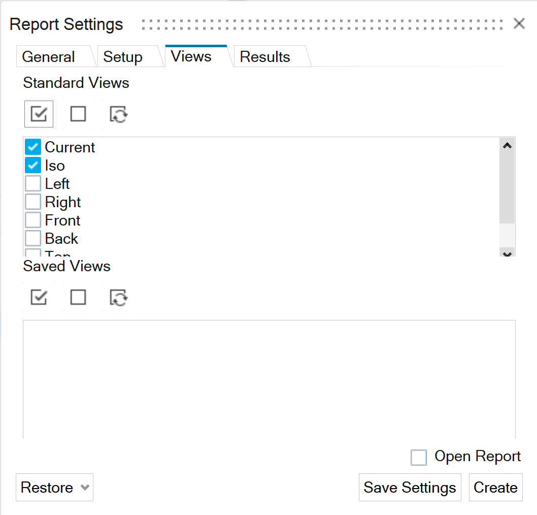

                On the Views tab:

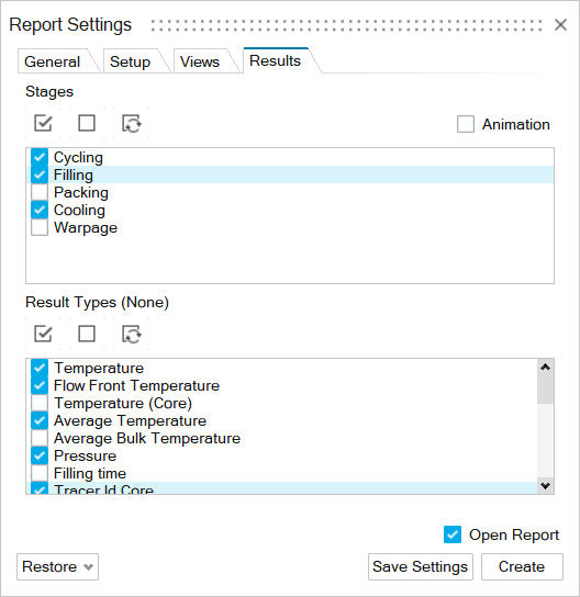

                In the Results tab:
- Select each Stage to include in the report.
 - For each stage, select each Result Type to include in the report.
 - To restore the default or custom settings, click Restore and select the desired choice. By default, the report title is the model name; the description is left blank; and an image of the model in ISO view, the first load case, and the first result type are included in the report.
 - Optional: To automatically open the report after creation, turn on Open Report.
 - Optional: To save the current settings, which will be used for quick reports, click Save Settings.
 - Click Create.
