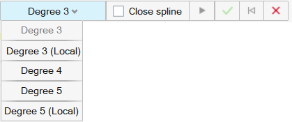

    Define the degree In the guide bar, select from:
    • Degree 2
    • Degree 3
    • Degree 4
    • Degree 5

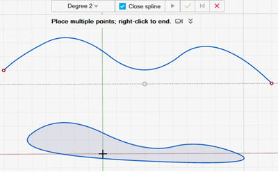

    Close the spline on creation In the guide bar, turn on Close spline.

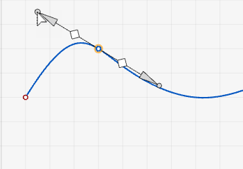

Spline Through Points

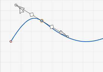

Spline Using Control Points
