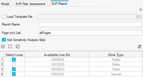

- Sensitivity Analysis Selection in Automatic Report
- When creating an automatic report, you can now select which E-lines
                            should be included in the report for sensitivity analysis.Figure 1.
