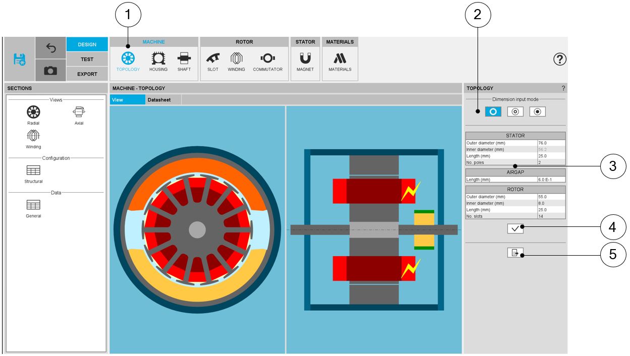

The first step of the design consists of defining structural data of the machine.
However, at any time, it is possible to reach and modify the structural data from the Motor Factory design environment.
Here is the process to modify the structural data from the general data panel.
| Process to modify the structural data | |
| 1 | Open the TOPOLOGY panel (Click on the icon TOPOLOGY) |
| 2 | Choose a way to define the diameters of the machine and the airgap See additional information below. |
| 3 | Modify the values of structural data – When relevant, the corresponding arrow is displayed on the view |
| 4 | Button to apply inputs |
| 5 | Icon to export data into *.txt or *.xlsx file - Please see above illustration |
