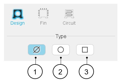

Type of frame
In this section, three choices are available to define the type of frame topology: None, Circular or Square.
By default, housing type is set to “None”. There is no frame.
Important: When “None” is selected, access to External cooling and Internal cooling environments is locked.
Table 1. Shape frame design area - Housing type available
1 Default setting: Housing type is « None ». The machine has no frame.
2 Button to select a circular-shaped frame.
3 Button to select a square-shaped frame.

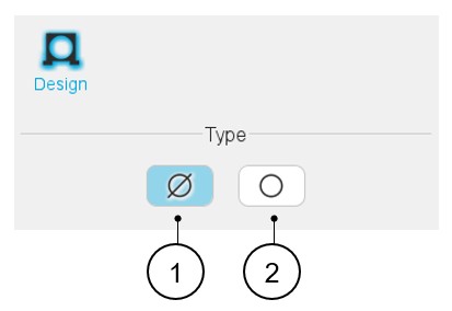

Table 2. Housing design area – Housing type available for outer rotor topology

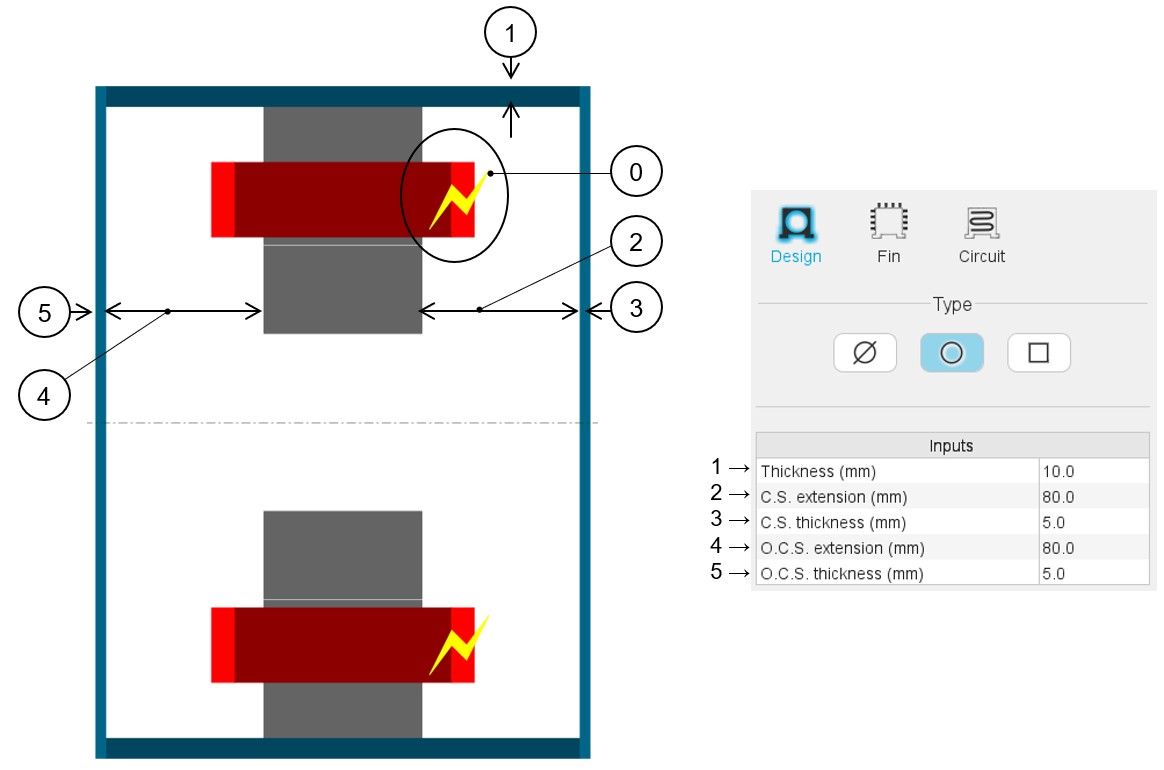

Circular shape
Table 3. Shape frame design area - Circular shape - User input parameters to define the frame dimensions in the axial view
0 Definition of the Connection Side (C.S.). It is identified by yellow lightning. The other side is called the Opposite Connection Side (O.C.S.). This helps to easily differentiate between both sides of the machine.
1-5 User input parameters to define frame dimensions in the axial view.

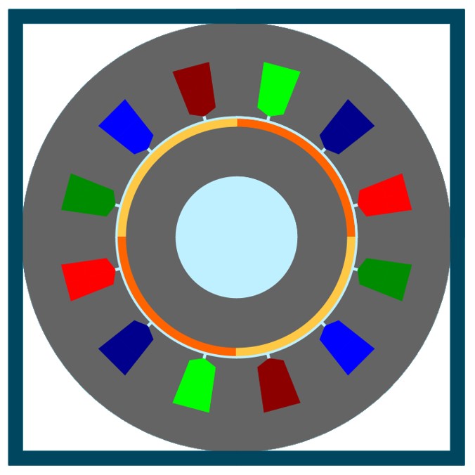

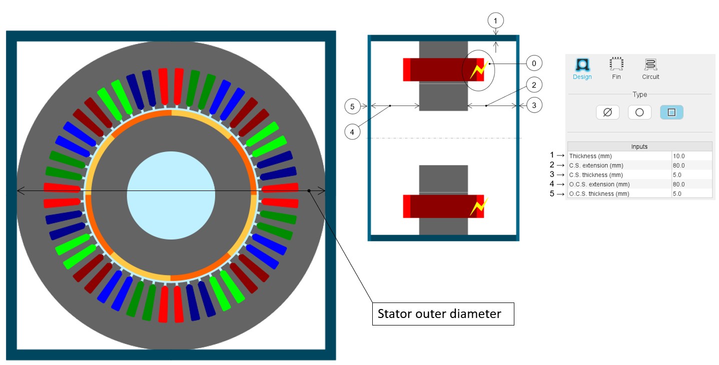

Square shape
The user inputs for defining the frame dimensions in the axial view are the same as in the case of the circular shape frame.

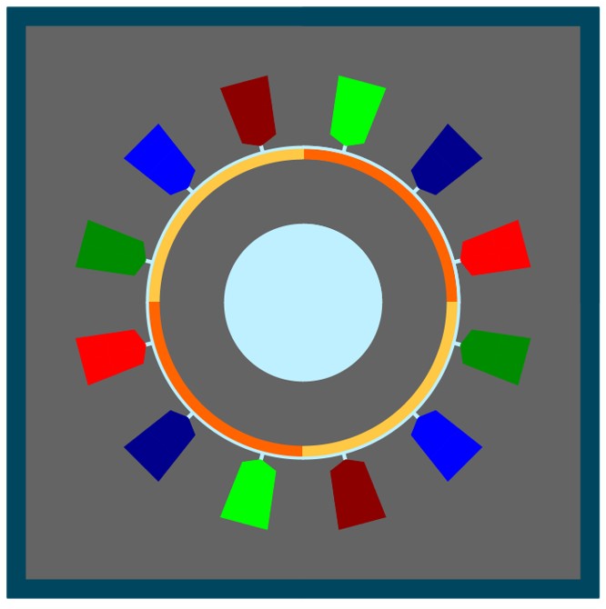

Important: The square shape topology is only available for inner rotor topology.
Note: The inner length of the square shape frame is automatically defined by the stator outer diameter, which is defined as structural data in the specification.
Note: The illustrations below are based on the SMPM-IR machine. However, the principles described apply to all machine types, including the IMSQ-IR for instance.
Figure 1. Shape frame design area - The inner length of the square shape frame
Validity domain
Here are the allowed range of values of the frame dimensions in the axial view:
  • Thickness of the frame: ]0, 50] mm.
  • Connection side extension: ]0, 20000] mm.
  • Connection side – End-plate thickness: ]0, 50] mm.
  • Opposite connection side extension: ]0, 20000] mm.
  • Opposite connection side – End-plate thickness: ]0, 50] mm.

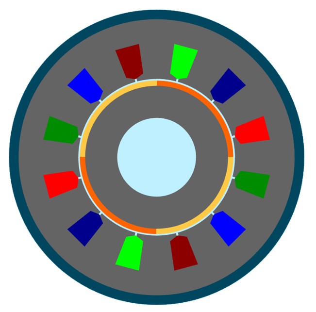

Combination between lamination outer shape and frame types
Table 4. Combination between lamination outer shape and frame types
Frame type
None Circular Square
Lamination
outer shape
None
Circular
Square
Table 5. Combination between lamination outer shape and frame types
Circular shape lamination &
Circular shape frame
Square shape frame
Square shape lamination &
Square shape frame
