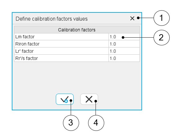

  3. Model refinement = X-Factors
    When “X-Factor” is selected, a list of X-Factors to be applied to each parameter of the equivalent scheme must be defined by using the next field: “X-Factors to be applied” and by clicking on the button “Set values”.
    The second one, “X-Factors” (X-Factor) gives to the user the capability to adjust the parameter of the equivalent scheme manually. The manual adjustment is made thanks to X-Factor parameters which must be filled in the field “X-Factor”.
Table 1. Model refinement = X-Factor
1 Select the “X-Factor” option.
2 Click the button “Set values” in the field “X-Factors to be applied” to open a dialog box to define the X-Factors to be applied on each parameter of the equivalent scheme.
3 Button to validate and consider the user inputs
4 Button to run the computation
X-Factors
When “Model refinement” (Refinements to improve the original model) is set to “X-Factor” (X-Factor), “X-Factors” must be provided (X-Factors applied on electrical components). When the user clicks on “Set values” a dialog box appears allowing the user to set X-Factors values.
There are four X-Factors, “Magnetizing inductance factor”, “Iron loss resistance factor”, “Leakage inductance factor” and “Rotor Joule loss resistance factor”.

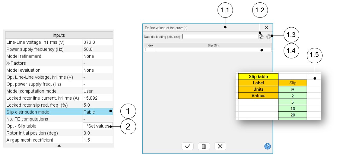

  3. Slip distribution mode = Table
    When “Table” is selected, the list of slips to be considered must be defined by using the next field: “Slip table” and by clicking on the button “Set values”.
    Two ways are possible to fill the table: either filling the table line by line or by importing an excel file where all the slips to be considered are defined.
    Note: The slips must be listed in ascending order.
    Table 2. Slip distribution mode = Table
    1 Select the “Table” option.
    2 Click the button “Set values” in the field “Slip table” to open a dialog box to define the list of slips to be considered. Refer to the next illustration which shows how to fill the Slip table.
    1.1 Dialog box opened after clicked on the button “Set values” in the field “Slip table”.
    1.2 Browse the folder to select an Excel file which is defined the list of slips.
    1.3 Button to refresh the table data when the considered Excel file has been modified.
    1.4 Fields to be filled with data to describe the slips to be considered.
    1.5
    Excel file template to define the list of slips.
    Excel template used to import a list of slips is stored in the folder Resource/Template in the installation folder of FluxMotor.
