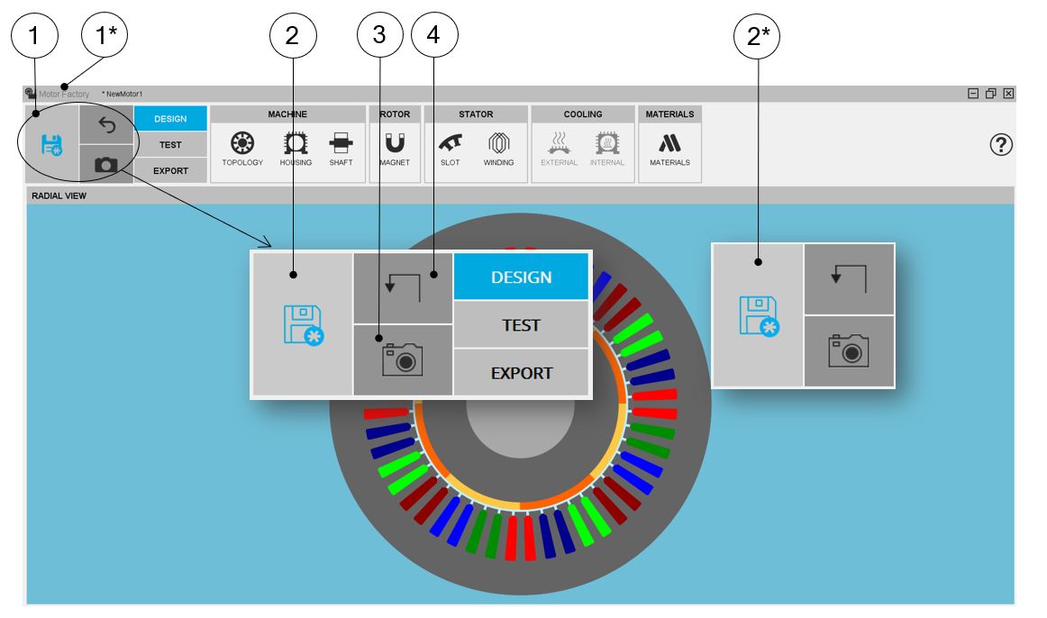

Expanding the menu in the left top part of Motor Factory – for any area: DESIGN, TEST or EXPORT allows to visualize and select these functions.
The main ways to access to the functions like SAVE, SAVE AS or STORE are illustrated below.
| 1 | SAVE function (disk), STORE function (Camera) or UNDO (Back arrow) are accessible directly from the main area of Motor Factory. |
| 2 | When expanding the menu in the left top part of Motor Factory – for any
                        area: DESIGN, TEST or EXPORT gives access to the main system functions. All these functions are explained and illustrated below. |

| 1 | Click on one of the three main buttons to use some main system
                        functions.
 Note: These three functions are available in the
                           DESIGN and TEST area. In the EXPORT area, Undo action is not available
                           (See “expanding the menu in Motor Factory”). |
| 1* | Clicking on this zone allows access to the main menu. |
| 2 | Save motor changes: to save the current project, by keeping the same name of the motor which remains in the catalog. |
| 2* | A new button to save motor changes appears when any modifications are done in the description of the motor inside Motor Factory. |
| 3 | Store motor by using the camera button. Store a motor means that a copy of the current motor is stored in a catalog using a new name. User must give a new name of the motor and select an existing catalog in which the motor will be stored.). Note: This command
                           allows user to continue working on the current motor.“Store” can also be
                           selected from the main menu (ref. 1* - See “expanding the menu in Motor
                           Factory |
| 4 | Undo action, to cancel the previous actions. |

| 1 | Expand the menu in the left top part of Motor Factory – can be used from all the DESIGN, TEST and EXPORT area. |
| 2 | List of actions available:
