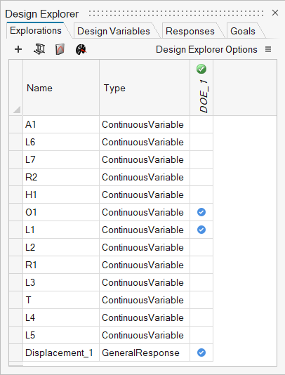

  1. From the Design Explorer ribbon, select the Explorations tool.
    Tip: To find and open a tool, press Ctrl+F. For more information, see Find and Search for Tools.
    Now that you have entered the Explorations step of the Design Explorer workflow, you can create, review, and modify explorations.
  2. On the Explorations tab, click + Add Exploration, and then select an exploration type.

  3. By default, the exploration is named DOE_[Number] or Optimization_[Number], and it is saved in C:/Users/[username]/Documents/Altair/[version]/Inspire Cast.
    To Do this Note
    Activate a different exploration Right-click the exploration name, and then select Make Active. A single exploration name and study path will be used for each Inspire session. All explorations will be stored under the same study path. When the first exploration is evaluated, a <explorationname>.stmod file will be saved to the study path.
    Delete an exploration Right-click the exploration name, and then select Delete Exploration.
    Rename the exploration Right-click the exploration name, and then select Rename Exploration.
    Use all variables in the exploration Right-click the exploration name, and then select Select All.
    Deselect every variable Right-click the exploration name, and then select Deselect All.
    Create a new exploration using the same variables Right-click the exploration name, and then select Duplicate.
