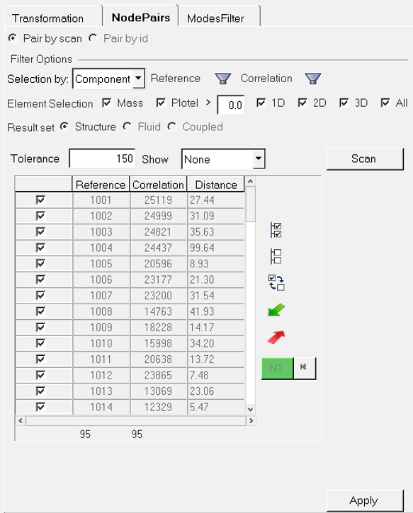

NodePairs
The next step is to identify the node pairs between the reference and correlation models.
Figure 3. NodePairs Tab
- Pair by scan
- Identify the node pairs by scanning within the user-specified tolerance.
- Pair by ID
- Identify the node pairs with matching IDs.
- Selection by
- Submodels can be defined based on finite element (FE) components, user-defined node
sets, or an assembly module structure (requires a module ID file).
From the Selection by drop-down menu, select Component, Set, or Assembly.
- Reference and Correlation Filters
- Click the filter icon,
, for the Reference or
Correlation filters to filter components to a smaller set of
data.You can show or hide components by moving them to the appropriate column.- hide comps
- A list of components that will be hidden in the display. You can move the
components from the hide comps list to the show comps list. To do this, select
one or more components from the list and click the right arrow
to move it to the show comps column. - show comps
- The components used for the node pairs. You can move the paths in the show
comps list back to the hide comps list to reduce the list of components. You can
move the modes from the show comps list to the hide comps list to reduce the
list of components. To do this, select one or more components from the list and
click the left arrow
to move it to the hide comps column.
- Click
to select the entire list of
components. - Click
to deselect your current selections. - Click
to exchange the currently selected components for the
unselected components in the list.
Figure 4. Filter Comps Dialog - Element Selection
- Select Mass and/or Plotel and enter a
length filter to identify element configurations.
You can also select 1D, 2D, and 3D elements by activating those check boxes.
- Result Set
- Structure
- Identify the node pairs for only structural modes.
- Fluid
- Identify the node pairs for only fluid modes.
- Coupled
- Identify the node pairs for coupled modes.
- Tolerance
- You can filter nodes in the models based on a user-specified distance tolerance. Enter a node pair tolerance value in the Tolerance field.
- Show
- Use the Show drop-down menu to display either Mapped Pair or Unmapped Nodes in the 3D modeling window. Nodes in the reference model are mapped with those in the correlation model.
- Import/Export
- Click Import
to import a
.csv file containing node pairs.
OR- Click Export
to export node pairs into a
.csv file.
- Click Import
- Scan
- Click Scan to scan the model files for the filters you have defined.
- Save
- Click Save to save the node pairs you have identified.
- Apply
- Once the node pairs between the reference and correlation models are finalized, click Apply. The utility automatically goes to the ModesFilter tab.
