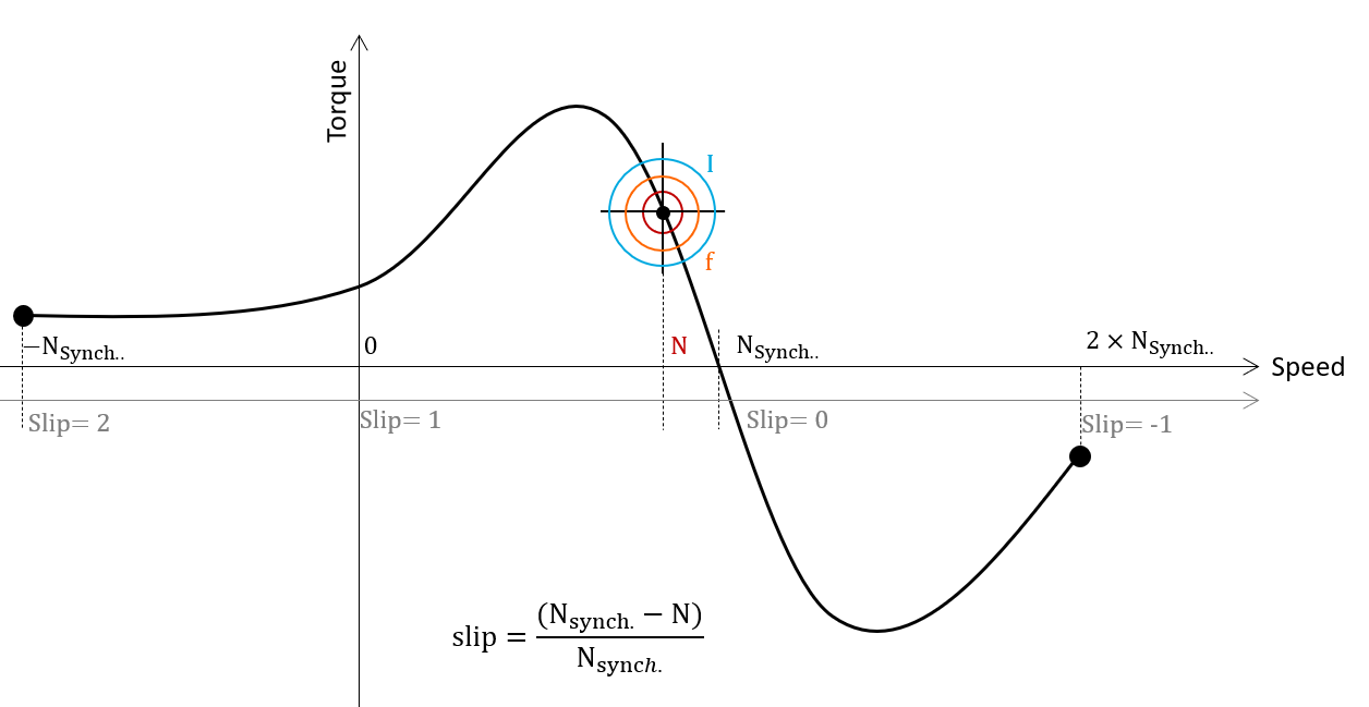

The aim of the test “Mechanics – NVH – Spectrogram – I-f-N” is to perform NVH analysis on the machine when operating at a set of targeted working points defined with the following inputs values U, f, N (Line-Line voltage, Power supply frequency, Speed).
This test is available only in the beta mode. It means that all the computation process and results are not entirely qualified yet. However, this gives users, the capability to use and to evaluate this new feature by themselves.
“Working point – Sine wave – Motor – I, f, N” Illustration |
