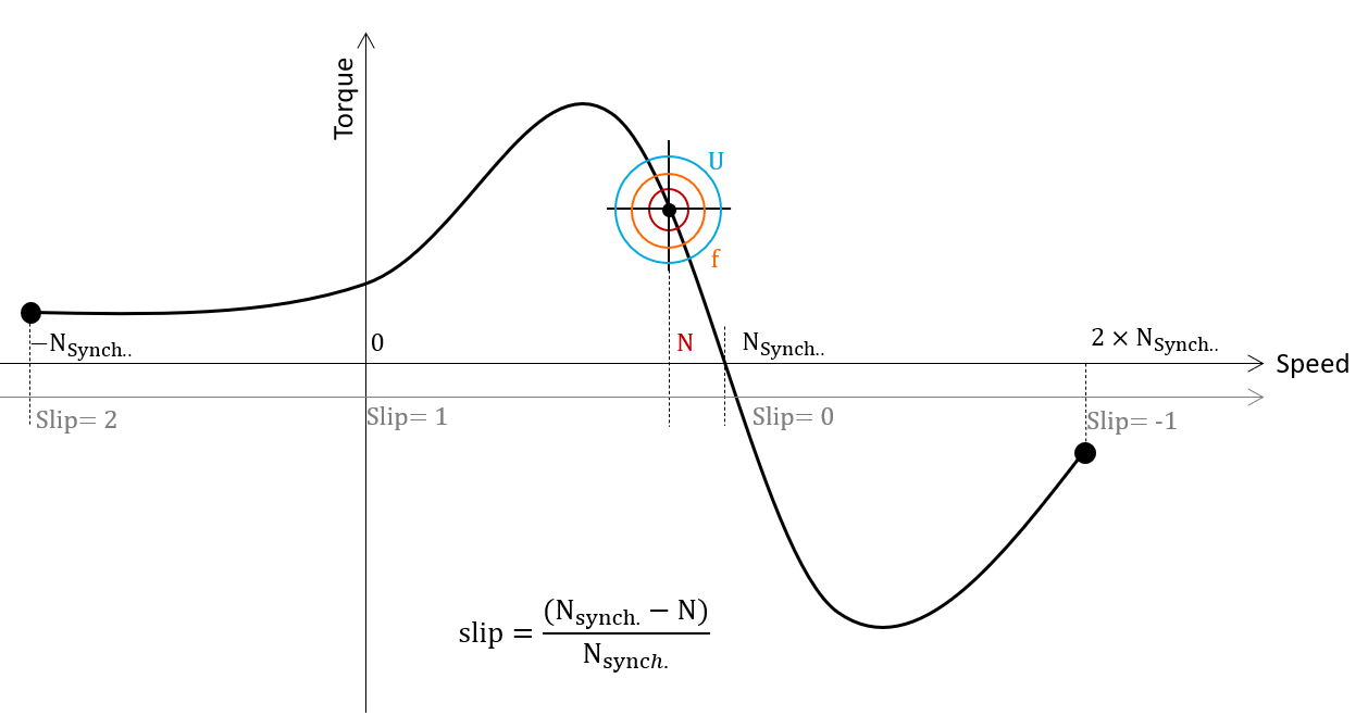

The aim of the test “Mechanics – NVH – Spectrogram – U-f-N” is to perform NVH analysis on the machine when operating at a set of targeted working points defined with the following inputs values U, f, N (Line-Line voltage, Power supply frequency, Speed).

“Working point – Sine wave – Motor – U, f, N” Illustration

The three main user input parameters are the supplied Line-Line voltage, the power supply frequency, and the speed (or the slip). In addition, temperatures of winding and squirrel cage must be set.
