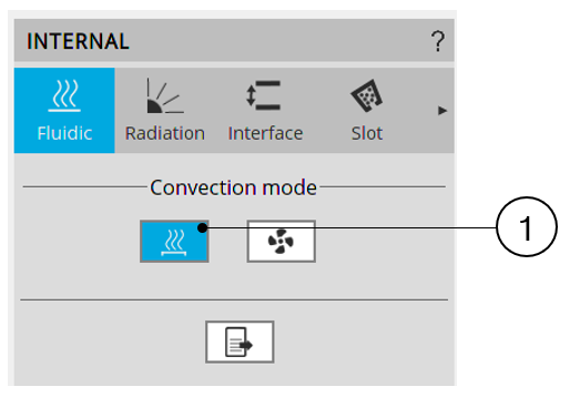

Natural convection - Inputs
1 Natural convection mode is selected. In this mode, there is no input to define.

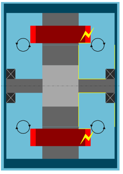

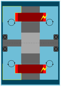

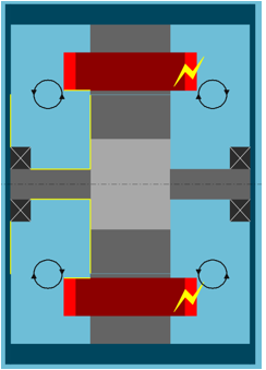

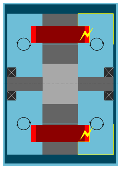

The end spaces are divided in four areas, corresponding to four inputs the user must defined in forced convection mode:
  • The « Upper » Connection Side region, corresponding to the Connection Side convection areas far from the rotating parts.
  • The « Lower » Connection Side region, corresponding to the Connection Side convection areas close to the rotating parts.
  • The « Upper » Opposite Connection Side region, corresponding to the Opposite Connection Side convection areas far from the rotating parts.
  • The « Lower » Opposite Connection Side region, corresponding to the Opposite Connection Side convection areas close to the rotating parts.
When selecting one of these four inputs, the corresponding exchange areas are highlighted in the axial view of the machine.
See below illustrations.
Opposite Connection Side “Upper” region – far from the rotor Connection Side “Upper” region – far from the rotor
Opposite Connection Side “Lower” region – close to the rotor Connection Side “Lower” region – close to the rotor

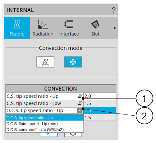

For all the four represented regions, the convection can be modeled with three different input ways:
  • A tip speed ratio
  • A fluid speed
  • A convection coefficient
The user can select the inputs mode of each region using the dedicated arrow or clicking on the input mode to change.
Forced convection – Selection of input modes
1 Click on the arrow, or directly on the input mode, to show the drop-down menu allowing the input mode selection
2 Drop down menu allows choosing an input mode for the dedicated convection region.

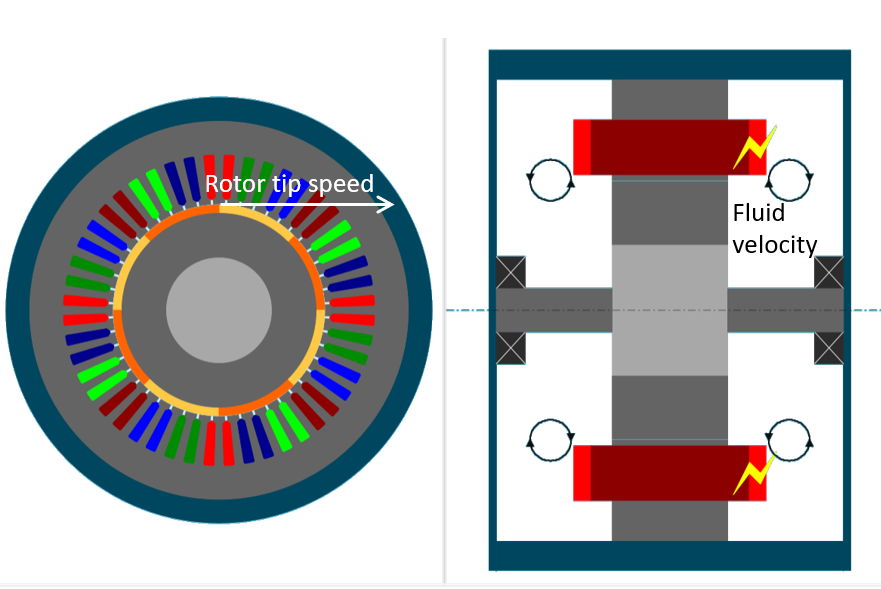

The « Tip speed ratio » input mode allows setting a fluid velocity proportional to the rotor tip speed.
Definition of the fluid velocity proportional to the rotor tip speed
This can be used to model a shaft mounted fan, of rotor fins.
The default values of tip speed ratios are 2 for the regions far from the rotor.
A tip speed ratio of 2 for an « Upper » region (meaning a region far from the rotor) corresponds to a shaft mounted fan, or rotor fins, that blows air to this region with an average efficiency.
For « Upper » region of a side without fan or fins, it is advised to set a rotor tip speed ratio of 5. This corresponds to the FluxMotor natural convection model.
The default value of tip speed ratio is of 1.5 for the regions close to the rotor.
In fact, for these regions, the considered fluid speed is the relative speed between the fluid velocity and the rotating parts speed, meaning that in these regions the convection is highly related to the rotation speed.
The « Constant fluid speed » input mode can be used to model a constant ventilation speed.
The «Convection coefficient » input mode allows directly forcing a convection coefficient in the corresponding region.

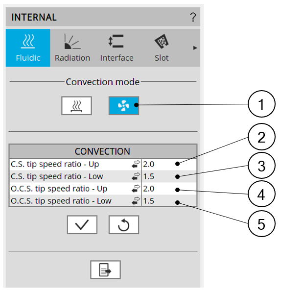

Forced convection - Inputs
1 Forced convection mode is selected
2 Input related to the Connection Side “Upper” region, here set as a tip speed ratio
3 Input related to the Connection Side “Lower” region, here set as a tip speed ratio
4 Input related to the Opposite Connection Side “Upper” region, here set as a tip speed ratio
5 Input related to the Opposite Connection Side “Lower” region, here set as a tip speed ratio
