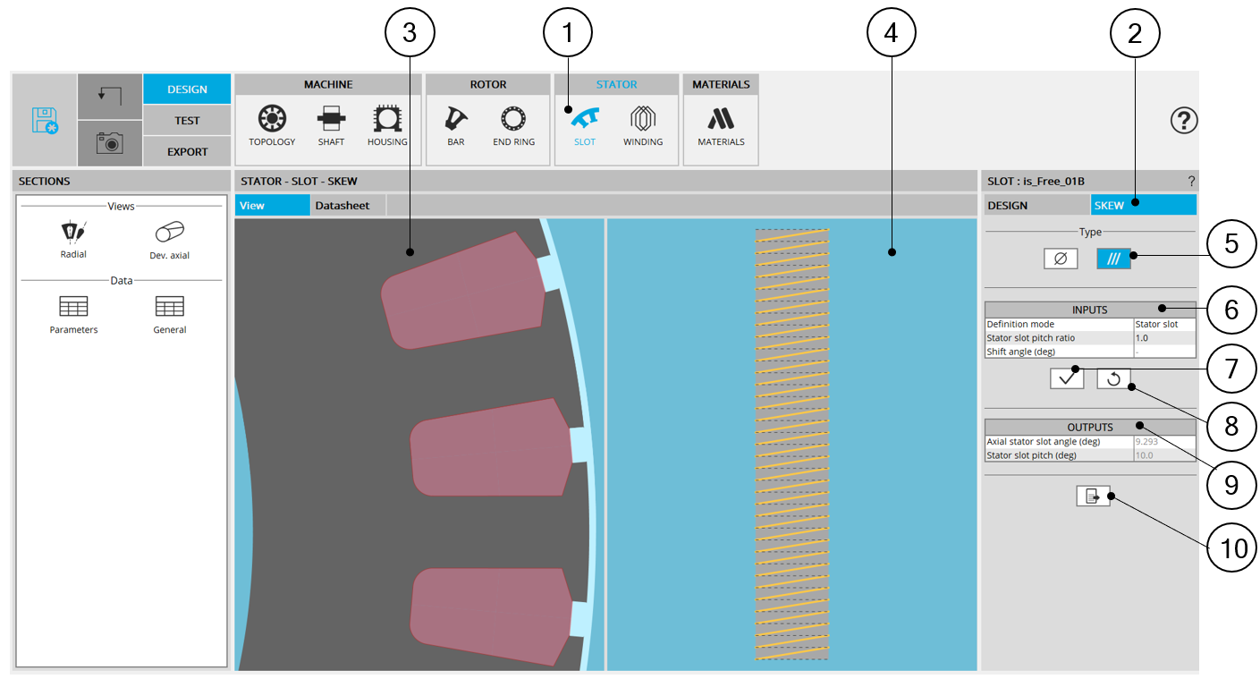

SLOT – SKEW design area | |
1 | Selection of the STATOR subset: SLOT panel (Click on the icon SLOT) |
2 | Skew tab indicates the tool to define the slot skew angle |
3 | Visualization of the machine radial view to visualize the slot skew |
4 | Visualization of the stator developed view to visualize the slot skew |
5 | Choices to define a skew: None – Continuous (Continuous in our example) |
6 | Skew inputs to be defined |
7 | Buttons to validate the inputs (Pressing the “enter key” twice applies inputs too). |
8 | Buttons to restore the default input values. |
9 | Skew outputs (read only) |
10 | Button to export the skew data into *.txt or *.xls files. |

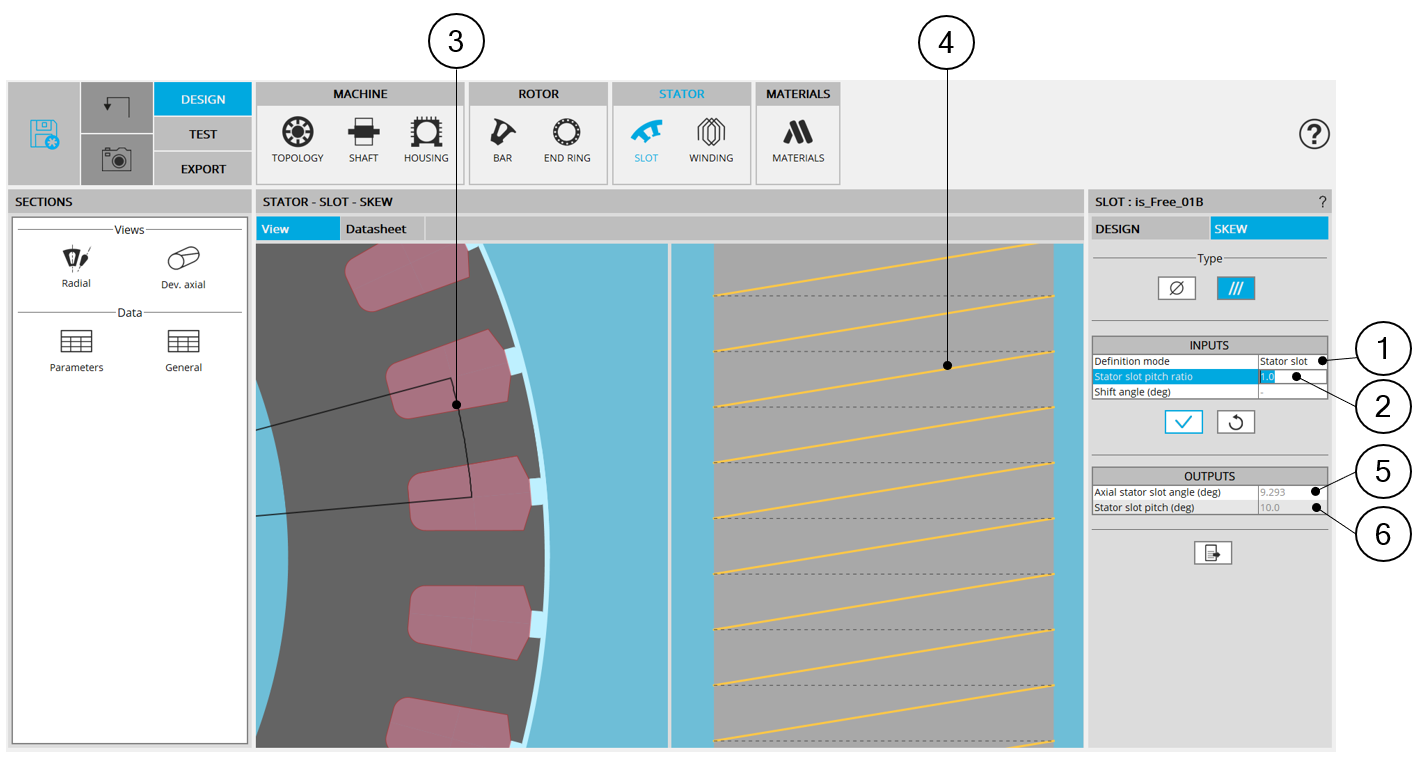

2. Set a skew angle
How to set a skew angle? | |
1 | Choose the definition mode of the skew: Stator slot – Shift angle |
2 | Definition of the skew angle depending of the definition mode |
3 | Visualization of the chosen skew angle on the machine radial view |
4 | Visualization of the equivalent axial slot angle on the rotor developed view |
5 | Equivalent axial stator slot angle (read only) |
6 | Equivalent stator slot pitch (read only) |
If a skew is already defined in the rotor when setting a skew on the stator, the rotor skewing will be automatically reset to “None”.
